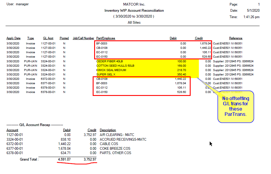

We’ve run into a problem where the Capture COS/WIP won’t process, because of out of balance transactions.
Here’s the Wip Recon report.
1 it doesn’t balance
2. there are no offsetting GL trans for those PUR-UKN transactions.
I think this happened because 4 parts were initially Buy To Order (BTO) items. But some one decided to create part numbers for them, after they were received as BTO items on the PO. The user then went back and changed the Order and PO to use the new P/N’s. It could have all been from some very unfortunate timing. The Tran type to be used when the item is received, is specified by the PO Release.

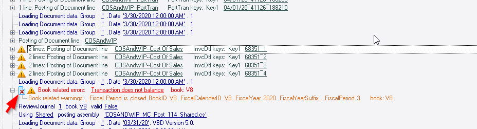

Have you looked at the PE Log viewer? (You probably need to enable COS/WIP and/or clear the log, then run the report again, as limited as possible.)
Did anything hit the review journal or is it not even making it that far? We have the capture COS/WIP hit the review journal a couple times a year due to… helpful users.
yes. those unbalanced trans showed up in the RJ.
I feel Like I should know this … But what is the “PE Log viewer” ??
Oh, it’s awesome. It’s like a debugger for the GL controls.
That’s the name of it - it’s a screen.
If inventory is accurate and you just need it to balance and post you should be able to add the offsetting accounts in the review journal. Then you can re validate and confirm the entry to at least get this one posted.

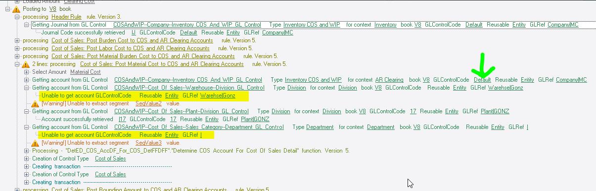

So after enabling logging and re-running the Wip Recon Report (which uses the posting rules to process - this duplicating the error condition), I see:
We are multi site and use GL Controls to substitute the Div segment, based on the site. But everything has worked fine up until now.

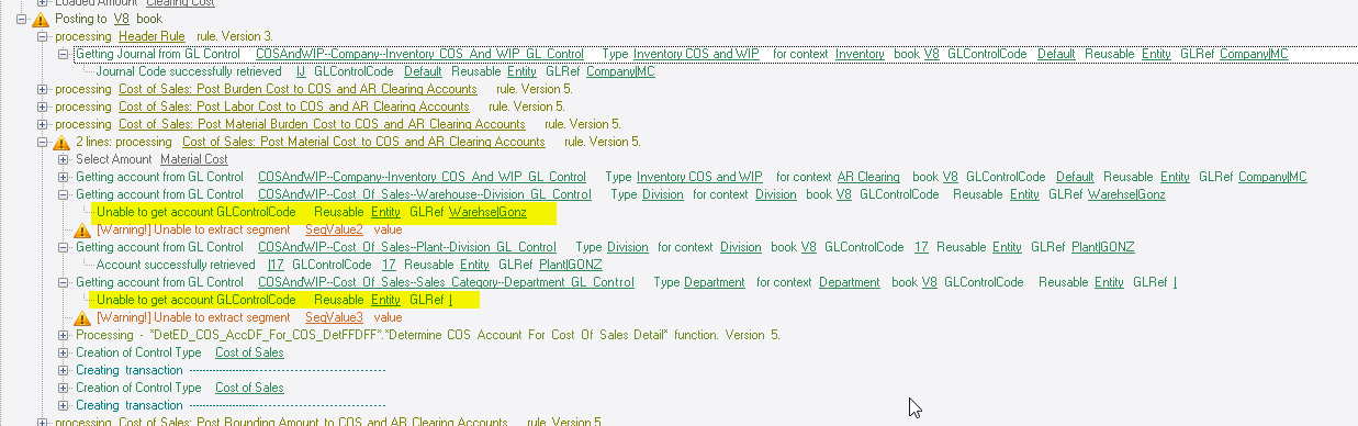

Calvin, those warnings are common and not bad, per se. Maybe you don’t WANT to define a division GL. We have them on one site but not the other (the main site).
There has to be another error somewhere.
OK wait, I read the second error more closely. It looks like there’s a sales category GL that exists but is blank.
I jumped on them being the issue, as I’ve had problems in the past where a substituting GLC (Like Site -> Division) was specifying an Account number that didn’t exist (we added a site but missed creating a GL account with that Division specified).
But this doesn’t appear to be my case. Every Account specified in the “Inventory COS and WIP” has a GL Acct setup for every site.

'Cause the thing is, in that screenshot, it grabbed an account (my green arrow), and that’s enough to post with.
It then tries to substitute a warehouse GL for the division, and didn’t find one, but then it goes to the plant GL and there is one. Then it tries to get a department from the Sales Category, but there is none, so that fails. But that’s still OK. When all else fails, it can always use that first account.
So you’re saying those 4 lines aren’t really a problem, but rather the one pointed to below:

Well… I’ve know it doesn’t balance from the start… I pointed out the trans in the original post that have no offsetting GL Tran

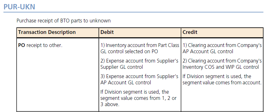

We setup a GL Acct for keep BTO separate from real (counted) Inventory. Normally a BTO Receipt Debits this special Acct (1166-00-01) and Credits Accrued Rcvng’s (3324-00-01)
I see Debits to 3324-00-01, but nothing for 1166-00-01
What’s the clearing account show in the PE log viewer?
That “BTO” reference in the guide is misleading, I say… It’s any “Other” PO line.
