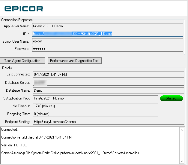

So good news, I was finally able to get the config test working
I had not really paid attention when I switched it from ncp to https, when I chose the connection method, I chose httpbinaryusernamesslchanel, instead of httpsbinaryusernamechannel, but I still cant connect after i log in.
Ok let’s start at the app server config leve. In the Application server settings, there are 3 configuration drop downs; one for Net.TCP, one for Http, one for Https; I believe multiple configurations are totally fine, however each client can have 1 and it has to match the server available endpoints.
When you do choose an endpoint, deploy the server again
On the client side, you don’t need to redeploy a client, but you do need to change the endpoint configuration.
In this case, using the client you have in the PDT, you’ll need to check the sysconfig on that. Specifically, the app server URL for a net.tcp will be different than an http scheme.
Secondly, in the EndpointBinding node, the value must match the option selected in the app server config. Do any of those things not match what you’ve tried already?
