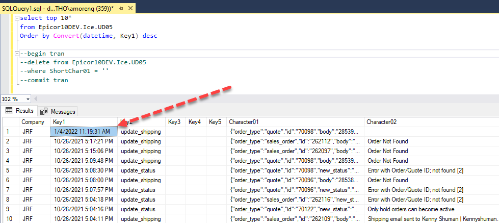

I cannot seem to get the Standard Directive to recognize table changes to that table, as it’s doing nothing when a record is added. I verified the table is being written to correctly, and I am certainly able to use a Method directive post-processing to see that the record was indeed written from wherever the event occurred to the UD05 table.

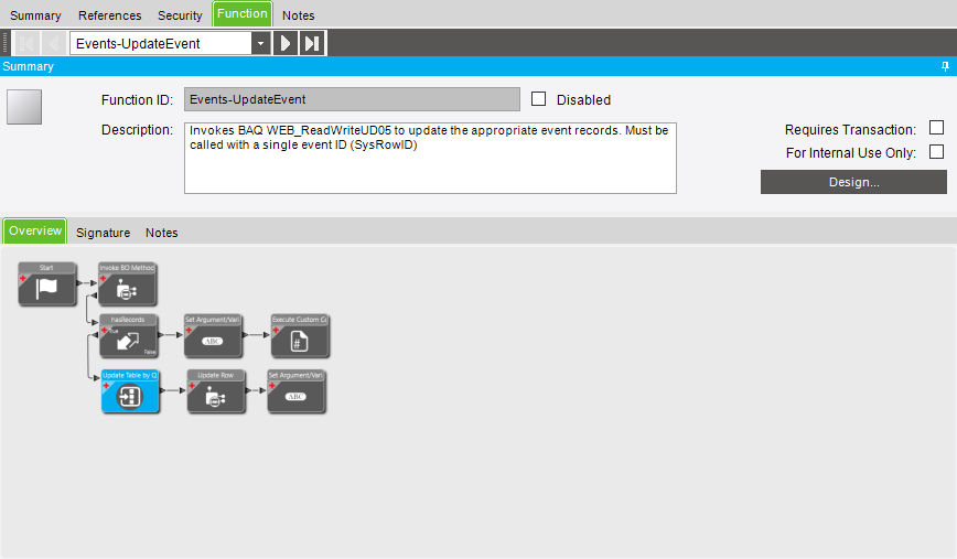

Hey, yes I do make extensive use of functions. I actually even designed a function endpoint to handle the event-processing from the calling application, but it was recently decided that they wanted to have an API endpoint on their end for me to call with event data rather than them calling my API to retrieve/callback with event data.
So, I do like the function approach. I do want to keep a nice clean log of transactions if possible to handle re-tries and history (which is why I went with a table approach first) but as I mentioned above, I do have some concerns if I trigger off UD05 and hen update a UD05 record, I am getting into a recursive issue…

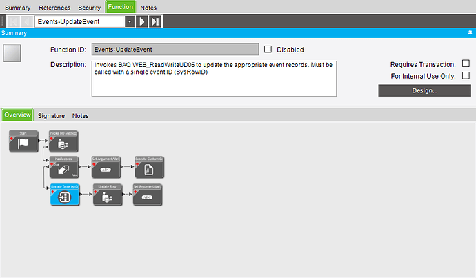

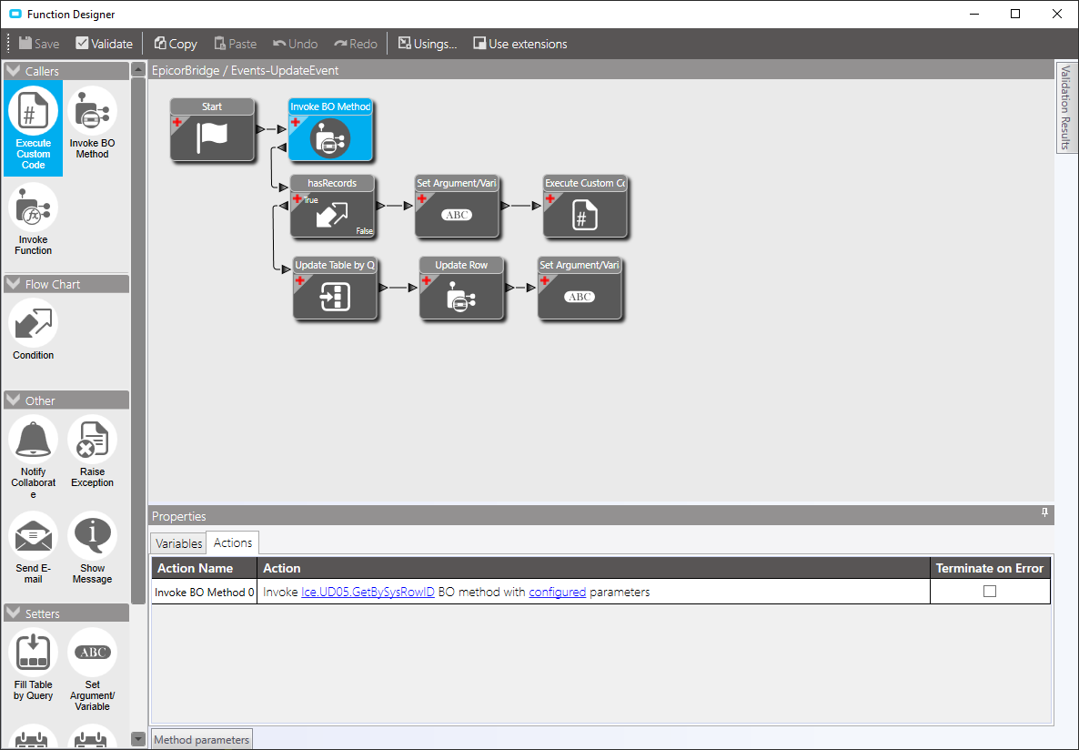

My event processing function is designed to consume a single event record (via a sysrowID) and then update the record with success/fail.
This is currently just handling the update of the UD05 record, so perhaps I could just create a new function to be triggered by the event writing BPMs (NOT UD05 add/update), have that query for to-be-processed records, then call this function for each row it processed.

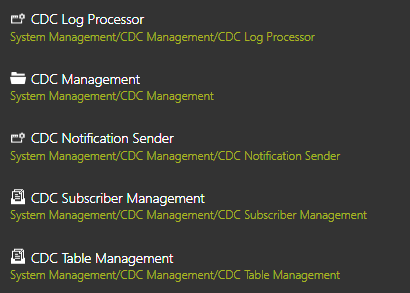

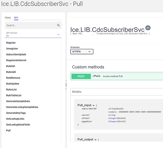

Yes I can write up something later. You can make CDC call your endpoint with json payload or you can have Epicor store it in SQL and there is a REST API Endpoint you can invoke to Pull “Unread” messages. Epicor will give them to you, archive them and delete the archive after x hours.
SELECT * FROM cdc.CaptureLog;
SELECT * FROM cdc.CaptureStatus;
SELECT * FROM cdc.Subscriber;
SELECT * FROM cdc.SubscriberQueue;
Start with
You only need CDC Log Processor running for Pulls and the Sender is only required for pushes.
Start with Pull its the simplest.

@Aaron_Moreng start with Pull its the simplest to see working.
Then later you can try Push and simply make a fake endpoint and you can sniff what data Epicor sends

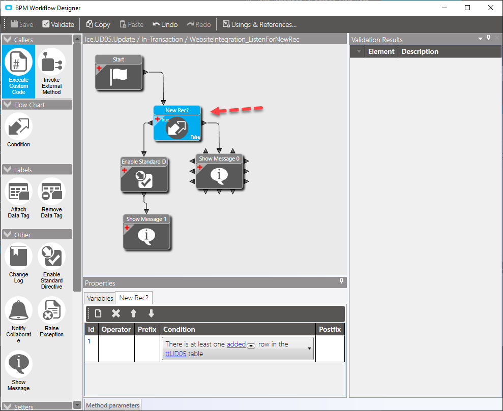

I’m trying it this way because it’s already like 99% built out, but I ran into something odd.
I am creating my UD05 records via code inside my event collecting BPMs. Does adding records that way somehow bypass the service layer?
I wouldn’t think so, however I have tried my In-Transaction BPM on UD05 to look for all kinds of rows (added, updated, unchanged) and spit out a message for either true or false. It’s never being triggered on the in-trans directive, however UD05 records are being created just fine.

In-Trans to enable Std directive (never triggers, true or false):
Data exists:
No, it should trigger your Data Directive just fine. Is your Data Directive Enabled?
Yes, I am beating my head against the desk on this one lol. Directives definitely enabled
I even tried replacing the code with widgets to create/update a rec, same results. The UD05 in-trans isn’t triggered regardless
