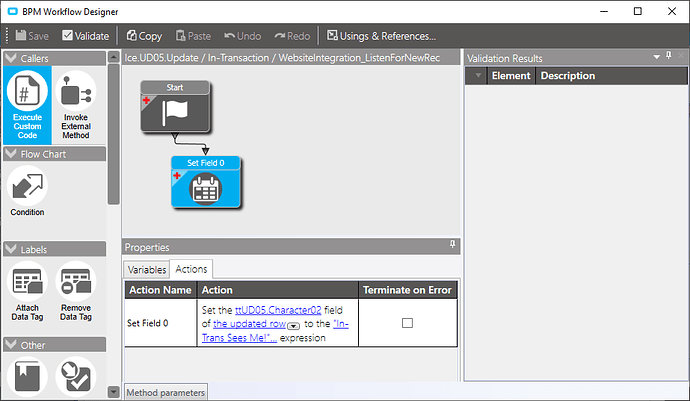

Given that your code is triggering the In-Tran, perhaps the MsgBox doesnt work.
You could try setting ttUD03 Character02 to “It works” in the Data Directive and see if it applies.

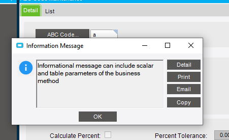

MessageBoxes probably assume you are being called from a Client UI.

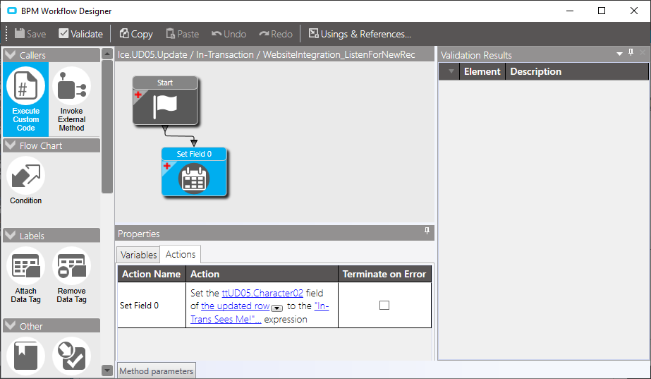

Ok I tried a field setter in the In-Trans (for both an “updated” and an “added” test) and neither took :confused:
You did do a “Added” as well right?
Correct. Probably time to step away and see if the oracles tell me what I’m doing wrong lol
Works on my machine :smiley:
I also tried variations with condition, without condition. Even the Info MessageBox worked.

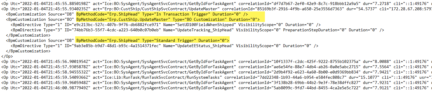

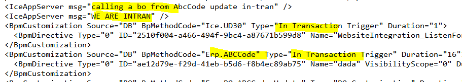

Check your Server Log
https://SERVERNAME/EpicorERP/ServerLog20220104.txt
I run my code inside ABCCode GetByID POST
Ok something must be goofed on my end…I’ll check it out
Where is your code that does the Update fire in, which BPM? I also tested it in ABCCode.Update.POST to make sure it wasnt a ds variable conflict.

Is it in In-Transaction Data Directive or Standard? If its inside In-Transaction then your Data Directive for UD05 may not fire. Usually your supposed to do those calls in a Method Directive :slight_smile:
You are technically “inside the base, of the base” and Epicor does Db.DisableTriggers()
Interesting…might be something. Perhaps moving those to the post processing of the update methods would get this working?
Maybe it depends which Data Directive and if Epicor disabled triggers… For example I can do it in ABCCode In-transaction just fine.

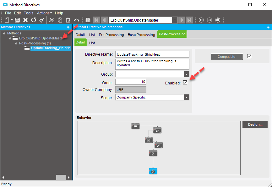

I re-created the same BPM on ShipHead.UpdateMaster.POST, and disable the old Standard DD on ShipHead which was/is responsible for writing the UD05 record.
Disabled Std. DD:
Created and Enabled PostProc BPM:
Same code, same behavior, still writes records to the table no problem.
I enabled trace logging for both “log” and BPM via the appconfig.
In the Standard DD for UD05, I took off all conditions and simply am writing to the log.
In my server log, I can see that indeed my ShipHead BPMs, both DD and Method work just fine, however the UD05 services I invoke in my code (which successfully creates records, mind you) nor my little diagnostics log message are anywhere to be found.
