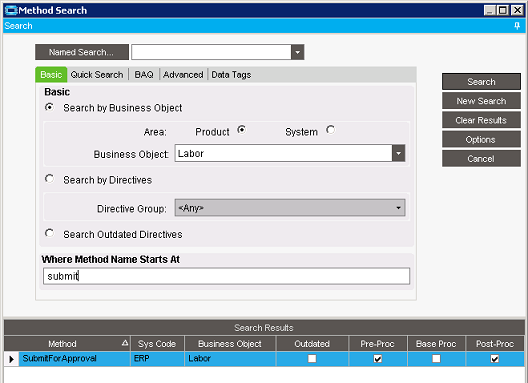

I think there are more than 100 methods for Labor
Maybe can try changing your search options or specify “start at” SubMitForApproval

P.S.
Ref screen shots below for the method search and directive maintenance forms…
The directive messages pop up when I submit a record from the Time and Expense entry form.
If this isn’t the method you need… have you already run a trace and identified the appropriate method(s)?
