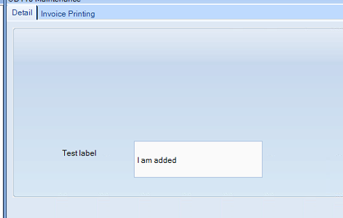

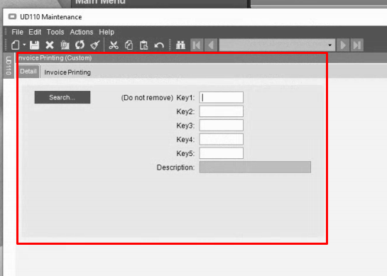

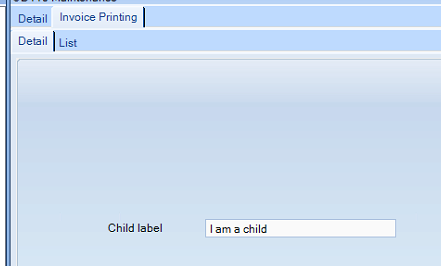

Your screen shot shows UD110. I had never played with a Parent Child UD screen before only the single table ones, so I played with this tonight and none of my changes didn’t take. But as soon as I did a new Parent and saved they came roaring back.
I usually hide those UD screens on for load rather than changing visibility as Epicor can change that on the fly.

Initially, the screen is similar to your screen shots, and i set the visibility to “False” for those control and then added the controls I wanted.
I didn’t know that Epicor could change the visibility on a fly, so I will try using the hide on loading of the screen.
It may have added issues with UDs over 100 that are parent child. I have only used the single table UDs to do this with.
