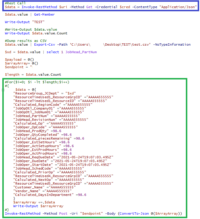

I have gotten to a point where the code does the rest call successfully and writes all the data to a CSV file that is parsed. What I need to do now is transition the data I am collecting, in blue, into the post method, in green. I have not found a way to do this successfully code and snippets below:

The iteration will be part of it for sure. The main thing I’m trying to do right now is get the first entry from the Get method to then be posted to my end point. The issue is I have no clue how to take the data from the get and apply it to the post requirements.
For instance in my get method I have a JobHead_PartNumber and in my post method I have a JobHead_PartNumber. I would like to post the first entry from the get method but cant get my data to tie in.

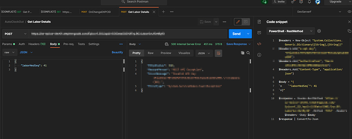

Did you try making the rest calls in post man? You can get the call information from swagger, use that URL to build your call in post man, and postman has a tab that will give you code for a bunch of different languages. Including Powershell.

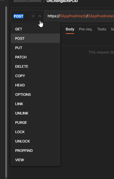

You can make get, post, patch… all kinds of rest types. I don’t understand your question.

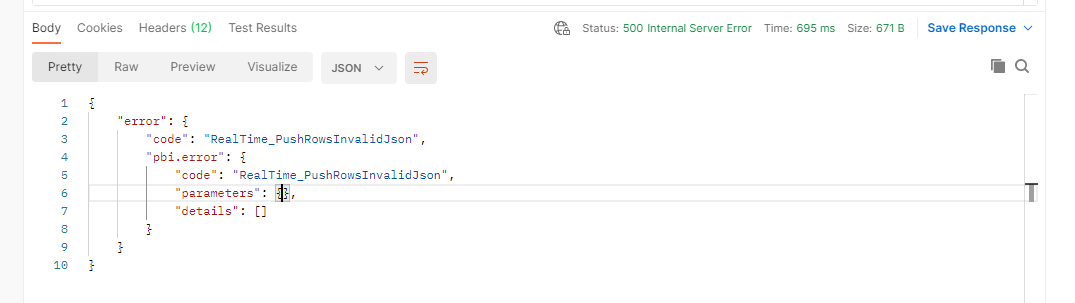

So I have a specified endpoint that powerbi wants the data to go to with the post method. However, when I run the post for the endpoint I am greeted with the following error:

I think I’m, getting somewhere with what Jose posted earlier and troubleshooting with Postman. I solid returns coming from our baq and I get solid posts from the standard setup given to me by powerbi. My question now is whether or not I can create a Foreach value loop at the tail end of the convertto-json statement and whether or not that will give me returns for all of my entries. Have you done something like that before?
