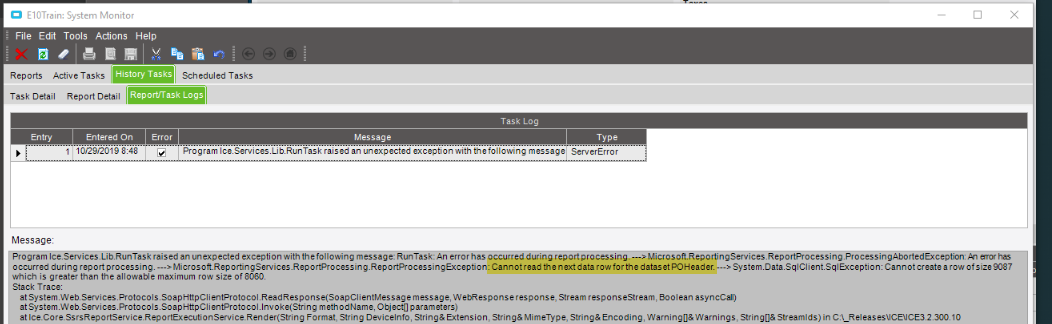

This just came up and I am guessing it has something to do with our changes to the form. We have customized the PO Form and we have PO with large header comments and 263 Lines. I am getting the following error when I try to print the PO. The base form prints fine.

it looks like one or more of the fields.value within the added columns has/have got more characters (counts) than what the table field defined to handle.

The issue is that SQL tables have a limit to how many fields show up, not how many characters are in the field. It is a hard, built in limit, which cannot be adjusted.

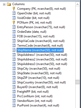

thats is right, what ever defined originally can not be changed, unless if it is UD fields because it will be defined as Max by default (maximum in SQL approximately up to 2 GB), and you can find this in MSSMS for example ShipName field in POheader table can not handle more than 50 string characters in my SQL database instance

I did not read the error message thoroughly. @A.Baeisa is correct, it is a field size limit issue. Try to print the report with a test PO which does not have the extra comments. If that prints, you know where the issue is. Its a process of elimination at this stage.

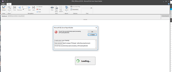

If I run the PO form in base form and use that guid on my custom form I get an error…should I be able to use this guid on my custom form…I thought I could…here is the error…Is this my problem???
Sometimes that might work, but if your data definition and data in SSRS report are different, the report expects a field that may not exist in the data, which will cause an error.

Based on your original error, i think your problem is in the PO header, not line (quantity), per highlight.
