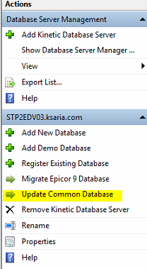

I found this KB article:
https://epiccare.epicor.com/epiccare?id=epiccare_kb_article&table=kb_knowledge&sys_id=57a0736093358610093631e17cba10ac&searchTerm=dbmigration
The steps are:
  1. Open the Epicor Administration Console
  2. Expand Database Server Management
  3. Click on your SQL Server
  4. Select Update Common Database from the Actions pane
This worked for me :slight_smile: I was able to update to .5 after
