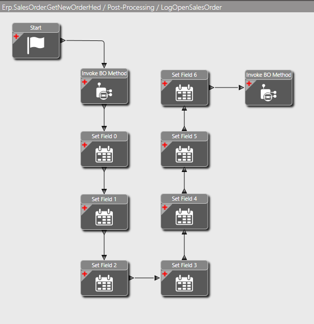

I am currently trying to run open on Erp.SalesOrder.GetNewOrderHed, but the problem there is the sales order number is not generated yet, even during Post-Processing. Which is one of my primary keys. I also tried to run this on the update, but that was worse. I was then going to make a 4th primary key that incremented by one, but then during the reporting phase, I would have to search for the highest record. Then, I would be putting useless data into that table because I only need one record.

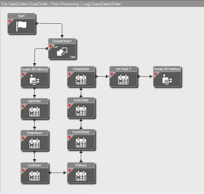

The closing one I do not understand at all. I am doing it on Erp.SalesOrder.CloseOrder Post-Processing.
Condition OrderHed.OpenOrder all rows is equal to false

I assume you have a full client trace (with full data set)? I am guessing, but the CloseOrder method may fire for each line item on the order, but only get to the second line when it gets the error and then stops execution. I would also check that the CloseOrder method retains the dataset data where you can use the Order Closed flag. The trace’s full data set would show if you’re missing something.
It is logging and displaying the data. I had dummy error messages in there at first displaying each field i was trying to track and write to a table to ensure the data was good.
The client trace doesn’t show the CloseOrder method firing more than once? then I’m stumped, unless the server trace shows something else. I suppose the server could be doing it without logging it to the client trace.

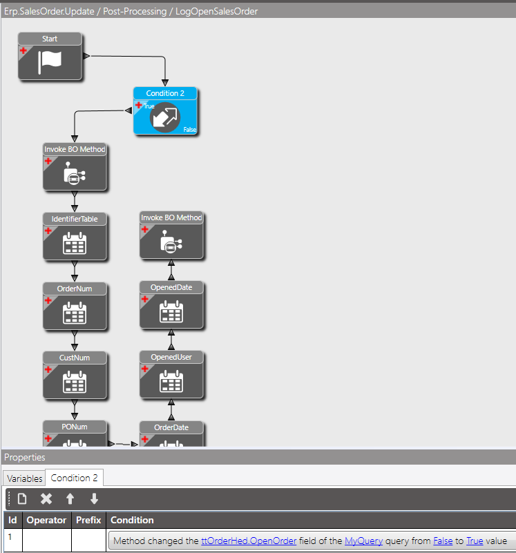

How was it worse? In theory, you could use the Update method for both ends but just look for when the OpenOrder field changes from true to false. Or to follow the logic of the ChangeLog, you could fire it at the Data Directive level doing the same thing. Then it wouldn’t matter what method opened/closed the order.
this is the OpenOrder tracking on Update. If I am thinking about it how @dr_dan explained it. The flag goes from False to True when the order first get opened.

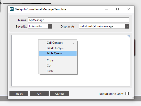

Since you’re doing it post processing, I bet it’s losing visibility of what changed. Do a test where you just pop up a message box and show the table ds.OrderHed and select the fields that you are trying to use and make sure they are actually showing data. I’ve experienced issues numerous times on PostProcessing where stuff that you would expect would be there is not.
The order number will never be available to the GetNewOrderHed method. That just gets the new order, sets defaults and displays it to the UI. At that point, your UI is still showing 0 as the order number. You’d have to wait until the post-processing method Update or MasterUpdate on a new record to have the order number available.

Could be. Do you have the option to include unchanged rows in your message? It may be that the value is present but that it doesn’t see the unchanged value. In theory, you’d see both an updated row and non-updated row. If this is the case, you can probably enable the post-processing directive from a pre-processing where you listen for the OpenOrder field to change from true to false. Then when that condition is met, use the Enable Post-Processing widget. Then in Post-Processing, you could set a condition that says “when enabled from XXX pre-preprocessing”
I do not believe it’s possible to create a new order and have it be closed. So, on the update, if you condition is “there is at least one added row” in your pre-processing, set an action to enable post-processing directives. Then, in the post, you’d have your order number and the OpenOrder flag should be false.
Or, your condition in the update could be:
OR the OrderHed.OpenOrder field has been changed from any to any
You’ll still want your logic in the post as the order number would not be available for new records in the pre.
