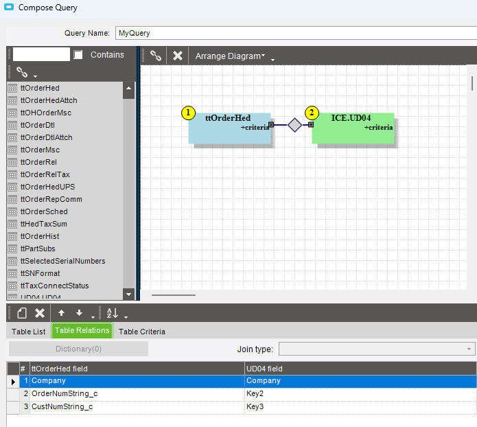

Create new UD fields on OrderHed called OrderNum (string) and CustNum (string). The reason why we did this is because there was already established logs to this table long before our time. They are using 3 keys Key1 either OrderHed or JobHead, Key1 JobNum or OrderNum to String, Key3 CustNum to String. I came up with the idea to create the new fields because I wanted to do a condition in the BPM to check and see if there were any records in the UD table already. The problem is because it is BAQ light (as i call it) i had to match a string to a string to link the UD04 and ttOrderHed tables.
Below is a picture of how my query is setup.

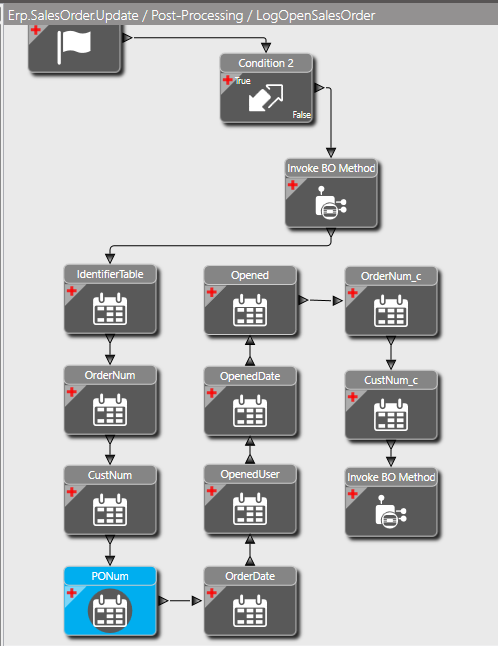

I am now logging the ordernum and custnum (string values) to the orderhed table in this BPM as well.
