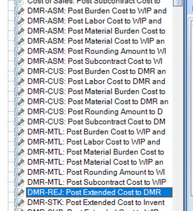

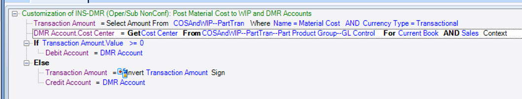

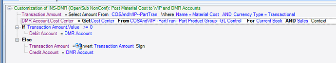

@utaylor We use a general MTL-INS account, but break down the PG for INS-DMR, DMR-REJ, etc for each cost layer. We have a cost center attached to a product group.

Greg, I am trying to understand this still, I’ll try to look for cost centers in application help and maybe that’ll lead me to where I need to go.
I take it that your screenshot is a custom posting rule?
