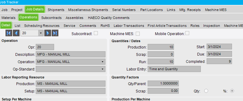

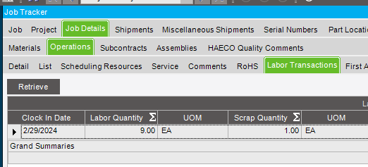

im doing some testing with Scrap. i created a test job for prod qnty 10. I have 3 operations, op 10 completed qnty 10. Op 20 completed Qnty 9 Scrapped 1 via MES, Op 30 still wants me to complete 10.
shouldnt op 30 show that only 9 will be completed because 1 got scrapped? Right now the process is for them to manually adjust the prod quantity.
also job tracker doesnt reflect the 1 scrapped. is this a 10.2 issue and works better in 11?
