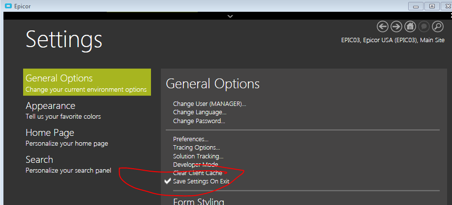

But if we’re talking the main Epicor program, I don’t know of a setting or a way to save it. I looked through the Config XML file and didn’t see anything obvious. I don’t know what Clearing the Client Cache does in its entirety, but it may be something you might consider doing, depending on your comfort level with Epicor.
You get to it from Settings >> General Options >> Clear Client Cache
Wow, how did I overlook that when I was looking at the Client Cache?? Yeah, do that first lol.

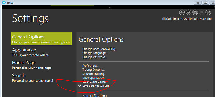

I have cleared the client cache many times and the Save settings on exit has always been checked.
I tried again for fun and it still opens on the 3rd screen.
