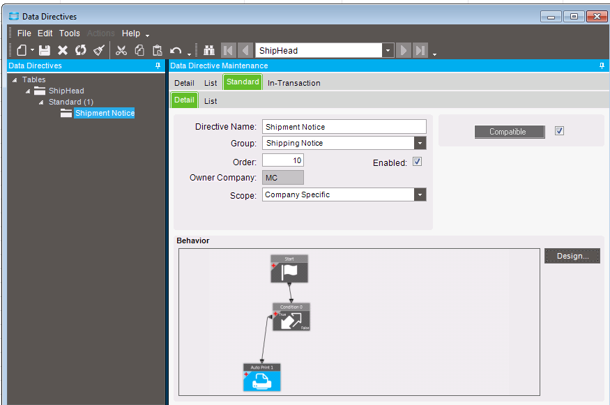

I created a data directive to email a copy of the Packer after either the Shipping Status changes to “Shipped”, or if the Tracking Number of an already shipped packer is changed.
Works fine if I’m the one that sets the packer to Shipped" or changes the tracking number. But nothing happens for any other user.
Thoughts on where to look?

It simply calls the AutoPrint (which is configured to send an Email) when the desired conditions are met. Some details below.
If I could display a message box in a data Directive, I’d remove the AutoPrint and just have it show a message for debugging.

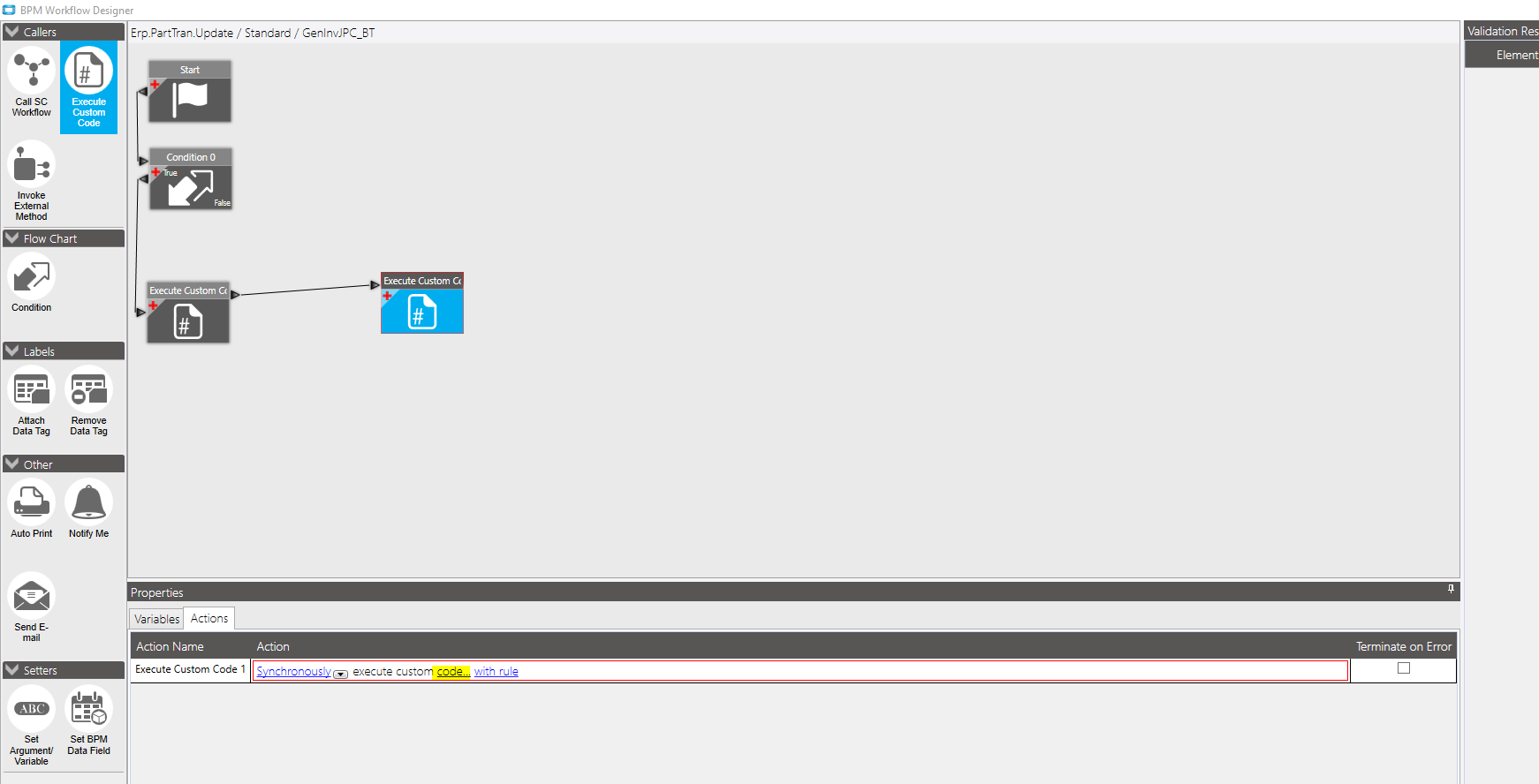

Since I’m still new to E10’s BPM interface, how exactly do I implement that code?
Replace the AutoPrint object with a “Execute Custom Code” ? Can I just put the ExecCustCode object between Condition0 and AutoPrint1 ?
Create a Custom Code object and enter the code (click the cod> link in the action bar)
Yes, you can insert the code into the chain. Note that since it’s synchronous, the events after that block wont occur until after you dismiss the message. As I recall, you CANNOT run the message box in a asynchronous context
