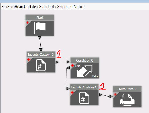

Is it possible to share a pic of your autoprint config?

Here’s my BPM (DataDirective)
ExecCustCode_1 and ExecCustCode_2 just display messages for debugging.
Both I and other users see both of them.

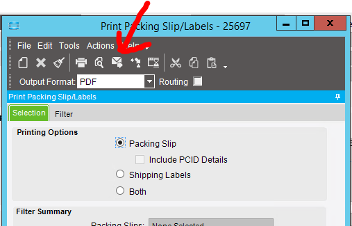

  • Created a user with all rights the same as typical users (Sec Mngr: NO, Allow Imp: NO)
  • This test user can send email using the email option in print dialogs (pict below)

Any user can email from a Print dialog window (like the “Print Packing Slip/Labels…” shown in post #32 of this thread). But emails generated from a BPM only work for the MANAGER account.
