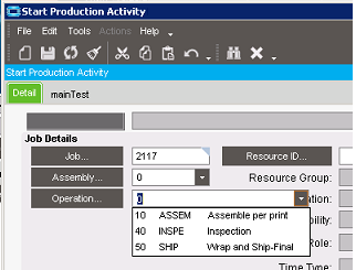

I am fairly new to Epicor and definitely new to customizing it. I am attempting to customize a few of the combo box dropdowns in the MES under the various activities menus so they will show the full assembly and operation name. Currently they are being cut off. I am able to customize other features of the box without issue, just not the width of the dropdown. Editing the “Dropdown List” settings doesn’t seem to do anything either. Any tips?

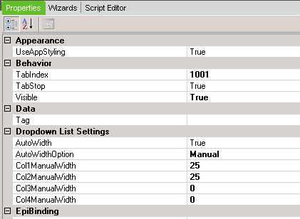

I wonder if something like this might work?
AutoWidthOption: Manual
Col1ManualWidth:… 25
Col2ManualWidth:… 50

Here is an example for an EpiCombo

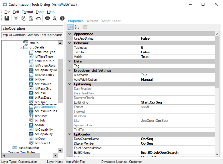

Well I assumed it was a default Combo. Here’s the customization window. I apologize for my lack of knowledge here.
OK…

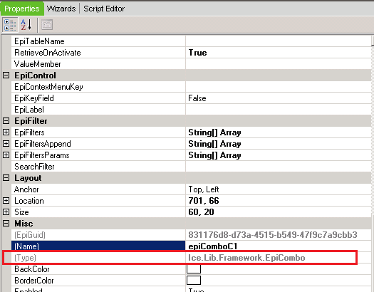

Can yo let me know what it says in the property “Type”
Ref screen shot…
Not all properties are necessarily displayed (or available) depending on which type.
So depending on the type of control, may need to try setting this with code instead of thru the properties form.

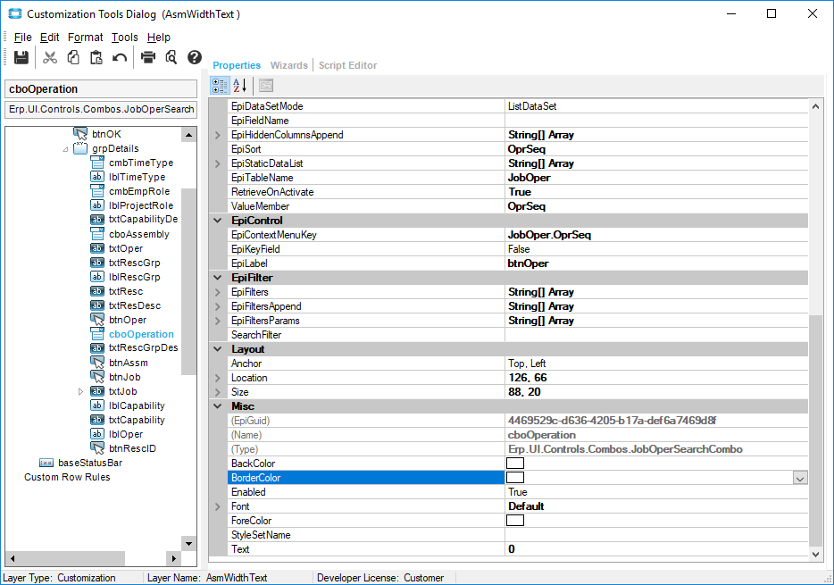

OK… now I see it’s a native control.
I glossed over your original mention of “MES”
TBD… if the properties exist for this control
and I’m guessing they do, should be able to modify thru code.

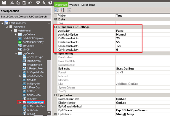

Note example case, I first increased the combo size to 200,20
and then modified the dropdown list settings - ref screen shot
resulting display
I’m working on the same form. Epicor is on version 10.1.400.27. As shown in earlier screenshots, the dropdown List settings only includes 2 options.
OK, I was able to verify your issue… the property sheet was limited in earlier versions.
Later versions of E10 show the settings you’d want.
So… you’ll be stuck modifying the extended props for this “native” control thru code.

// First - set the size = 200, 20 on the property sheet for the control
// Then add the following code to your forms StartProdForm_Load
// Reference to cboOperation - Erp.UI.Controls.Combos.JobOperSearchCombo
EpiUltraCombo myCombo = (Ice.Lib.Framework.EpiUltraCombo)csm.GetNativeControlReference(“4469529c-d636-4205-b17a-def6a7469d8f”);
// AutoWidthOption = Manual
myCombo.AutoWidthOption = (AutoWidthOptions)0;
myCombo.Col1ManualWidth = 25;
myCombo.Col2ManualWidth = 55;
myCombo.Col3ManualWidth = 120;
myCombo.Col4ManualWidth = 0;
