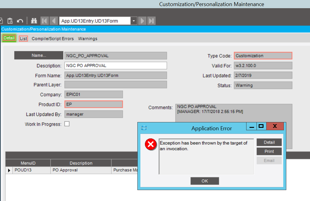

Looks like your Verify has issued a Warning. You may need to fix that before generating the EWA files.
There is no Error and Warning in EWA file after click on “Verify Customization”.
That’s not what the Status shows on your screenshot.
Do you have a custom code used in your customisation? If yes, Please check the code for null references.

There’s a Warnings tab on Customization Maintenance. That will show you any issues.
Dear Mark
  1. UD13 Form.
  1. No Error & Warning message in “Customization and Personalization Mainatenance” screen.
And the Status field on the Detail tab?
And the Verify on the Actions menu of Customization is the verify that we’re interested in, not the script editor. Run that and THEN check the compile/warnings tabs.
Detail Tab,
This runs in Epicor without EWA?
Yes, It runs in epicor without EWA.
I know not every command in Epicor runs in EWA. I wonder about all of these Infragistics controls act the same way in the webform. You may want to make a copy of the customization. Strip out parts and find out which piece of code is not converting properly.
Your other option is to create a separate web-version of this command with REST and a JavaScript framework - a Kinetic type of program.
Could you @Mark_Wonsil please run my customization in your environment?
I could but we don’t use EWA which is where your problem is.
We are totally fed up with this exception. Please anyone suggest.
Sometimes you have to initialize your .csm. fields in the Form_Load instead of InitializeCustomCode(); move all those grdList, txtKey… to _Load see how that performs.
Next proper steps would be, launch it with a Debugger / Visual Studio - it should pinpoint the exception.
OK, I will try and get back to you.
Dear experts, We have generated the UD web form successfully.
But csm object not found exception is coming while opening the Web form.
Can you please guide us, how to resolve this exception.
Try to Generate the web form in developer mode.
Enable the developer mode and double click the form customization – > Tools --> Click Generate the web form --> Select the check box Generate the developer mode --> enter the login details --> close the Internet explore --> Check Again
Regards,
Sanjeev
