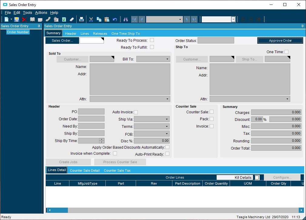

Good morning, afternoon which part of the globe you are!
I have a question for the veterans!
I have this Sales Order Entry, which I have customised by adding “Approve Order”, Order Status: Blank - I would like to click on the button for it to add “Approved” to the text box and auto print to a client printer and display a message saying it’s done with the order number
Do you know how I can do this?
I have created the UD Fields etc but now I’m stuck making that button bleedy work!
Any help at all guys would be awesome.
Kind regards,
Aaron.

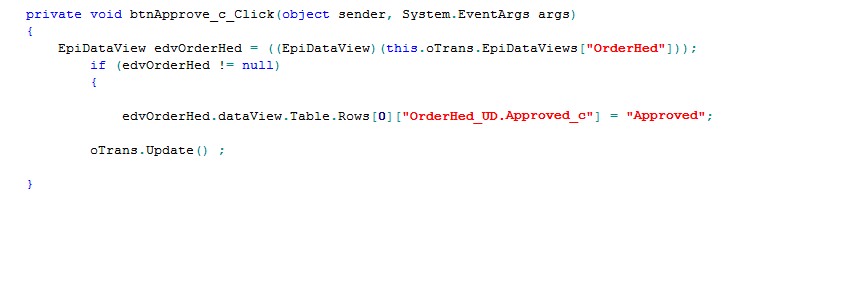

private void btnApprove_Click(object sender, System.EventArgs args)
EpiDataView edvOrderHed = ((EpiDataView)(this.oTrans.EpiDataViews[“OrderHed”]));
if (edvOrderHed != null)
edvOrderHed.dataView.Table.Rows[0][“OrderHed.Approved_c”] = Approved ;
oTrans.Update() ;

This customisation stuff isn’t easy!
private void btnApprove_c_Click(object sender, System.EventArgs args)
EpiDataView edvOrderHed = ((EpiDataView)(this.oTrans.EpiDataViews["OrderHed"]));
edvOrderHed.dataView.Table.Rows[0]["OrderHed_UD.Approved_c"] = value ;
oTrans.Update() ;
OK, it is saying you want to assign your Approved_c to the value of a variable called value but you never declared it. What do you want to assign to that variable? If it’s a boolean then true or false, if an integer then 0 or 1, etc.

Compiling Custom Code …
** Custom Code Compiled Successfully. **
But the text box doesn’t update with the words “Approved” what I am I doing wrong?

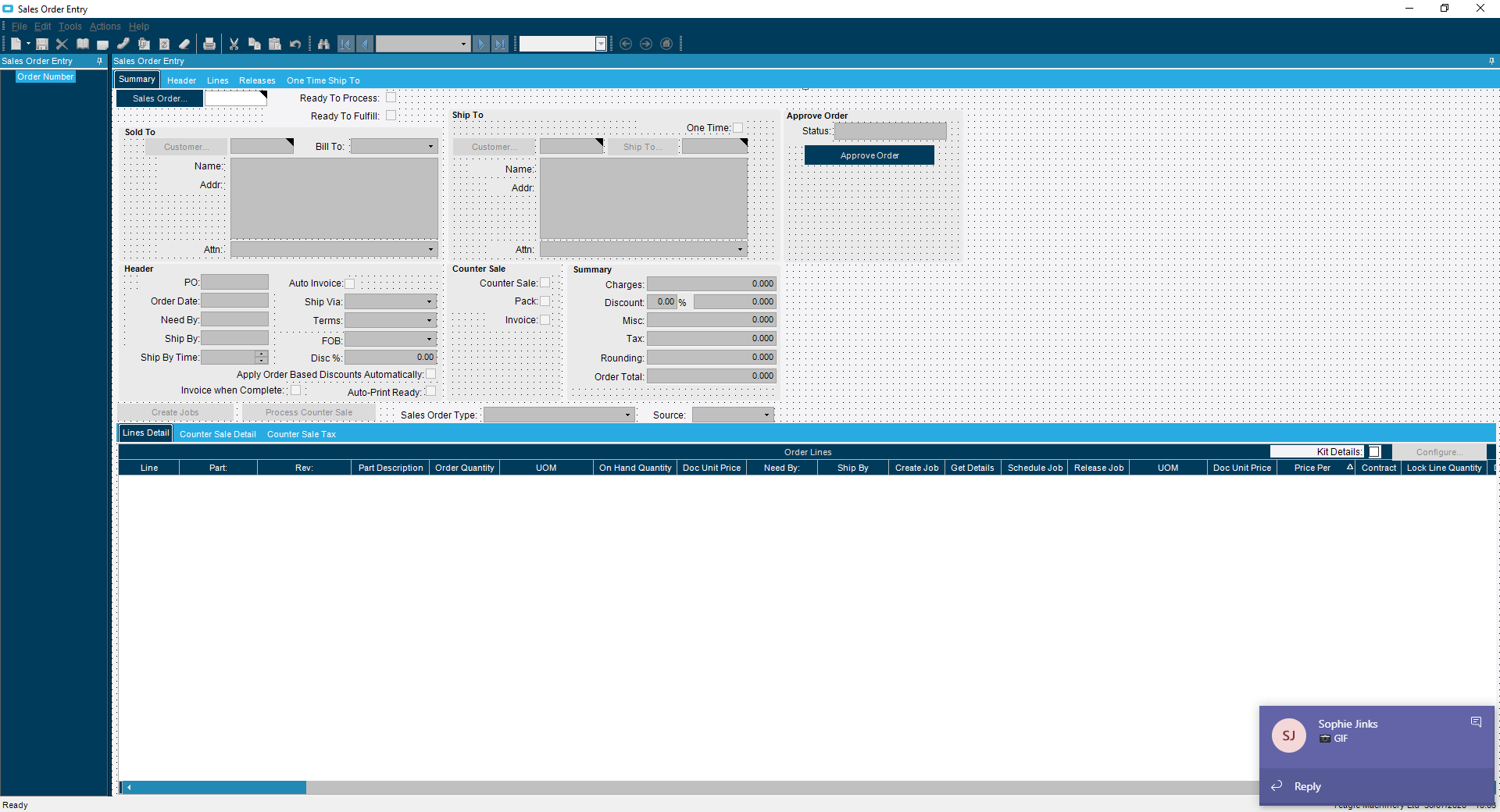

This what I’ve got going on
And your textbox has it EpiBinding set to your field? (Look at the properties of the Textbox in your customizations)
josecgomez
(Jose C Gomez)
July 30, 2020, 1:51pm
20
try
edvOrderHed.dataView[edvOrderHed.Row].BeginEdit();
edvOrderHed.dataView[edvOrderHed.Row]["Approved_c"]="Approved";
edvOrderHed.dataView[edvOrderHed.Row].EndEdit();
