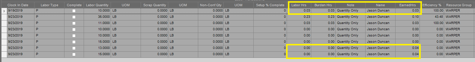

I know this is a rather old thread but I’ve been banging my head against the wall trying to get the final piece of this to work. I can get the detail record in and I thought everything was fine until I took a closer look at the transactions. No matter what I try I can’t seem to get the Burden and Labor Hrs to populate. The Earned hours populate just fine but the others stay blank.
The first row is a standard manual transaction. The last 2 are done through my customization.
