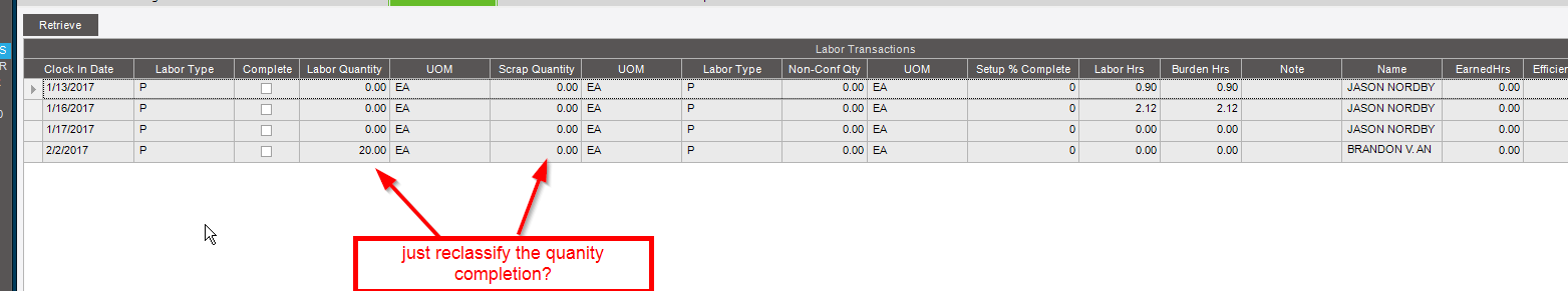

Does anyone know if it would be easier to add the scrap functionality somehow into the report quantity screen? I see that the transaction for the quantity complete show on the same lines as the scrap. Couldn’t another field in the report quantity be added that adds a record with a quantity in the scrap column instead of the completed column? Also, Beth had mentioned (I think in another thread) that she wanted more detail on why the scrap was happening, that seems like a good candidate for UD fields added and those extra classifications can be added the the report quantity screen. That would be much simpler than going through the whole non-con process and bring decisions to the lowest possible level like a good company does.
If this is a ridiculous idea, just say so, I don’t have the knowledge to do this, it just seems like a clean solution.
So I just walked through some of the steps and realized that report quantities basically makes a holding record that shows up in the labor transactions, but doesn’t create a labor detail record until you end activity. If you report quantities, it fills in that number on end activity. It also doesn’t backflush the material until you end activity. So if that’s important to backflush it real time, that wouldn’t work. However, I still think it would be nice to add scrap to the report quantities, because you can still create dashboards and alerts that would help notify people when the scrap happens because it could show up in the labor transaction tables, and then get written to labor detail upon end activity.
I would assume they wrote it that way to reduce the amount of labor detail transactions that are written in the system which makes sense to me.
If you wanted an immediate backflush, you could do something similar like I am doing with scrap, but for production quantity. Like you mention, you’ll have a ton more transactions. (Although I am getting more transactions with my scrap method as well). I did repurpose a comment field to contain MY scrap reason. The REAL scrap reason is still the standard/generic MFG FLOOR SCRAP, but you can get the scrap details in the comments.
I do plan on moving my scrap reporting to the report qty screen eventually. Currently, I have a custom job queue where I have a scrap button. For each job selected, I can scrap against it. I use that job queue to easily find, and select a job based on resource (as opposed to resource group like Epicor does) - you can even log into multiple jobs simultaneously.
The only downside of placing the report scrap on the report qty screen is that you can only scrap against a job you are logged onto. Not a big deal, but I like the flexibility of being able to simply report scrap without having to log into a job.

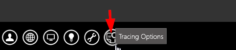

The best place to start is by running a trace and then reporting scrap. This will show you all of the business objects used, what methods, parameters and even the data in\out of those calls.
Are these SQL Server Profiler traces or traces within Epicor?
Sorry, I’m more familiar with SQL than I am Epicor. I’ve only found maybe two or so videos that pertain to Event Wizards inside of Epicor as far as customization goes.
Yes, that would be the start, but it goes way more in depth. You’ll be using adapters for business objects. Look in EpicWeb for the ICE Tools manual and Customization Manual
