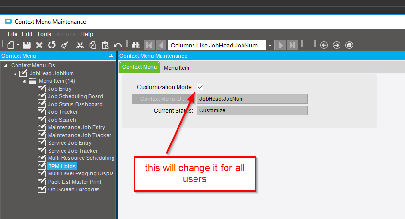

Nope, If you are in customization mode, you can change it for all users.
check the help for an explanation.
It is a bit confusing, and there seems to be a lag when as to how long it takes to do into effect. But it does work.
Right you are. It is either ALL or individual. Thanks for the correction.

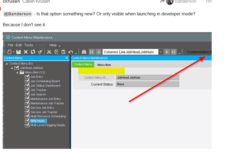

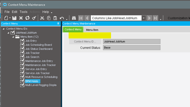

@Banderson - Is that option something new? Or only visible when launching in developer mode?
Because I don’t see it.
scroll all the way to the right… or maximize the window
They moved it.
Wow … I never look into the menubar for form specific fields. And the default color scheme does a good job of camouflaging it.
