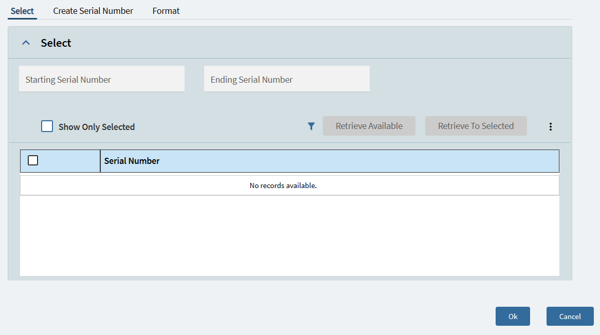

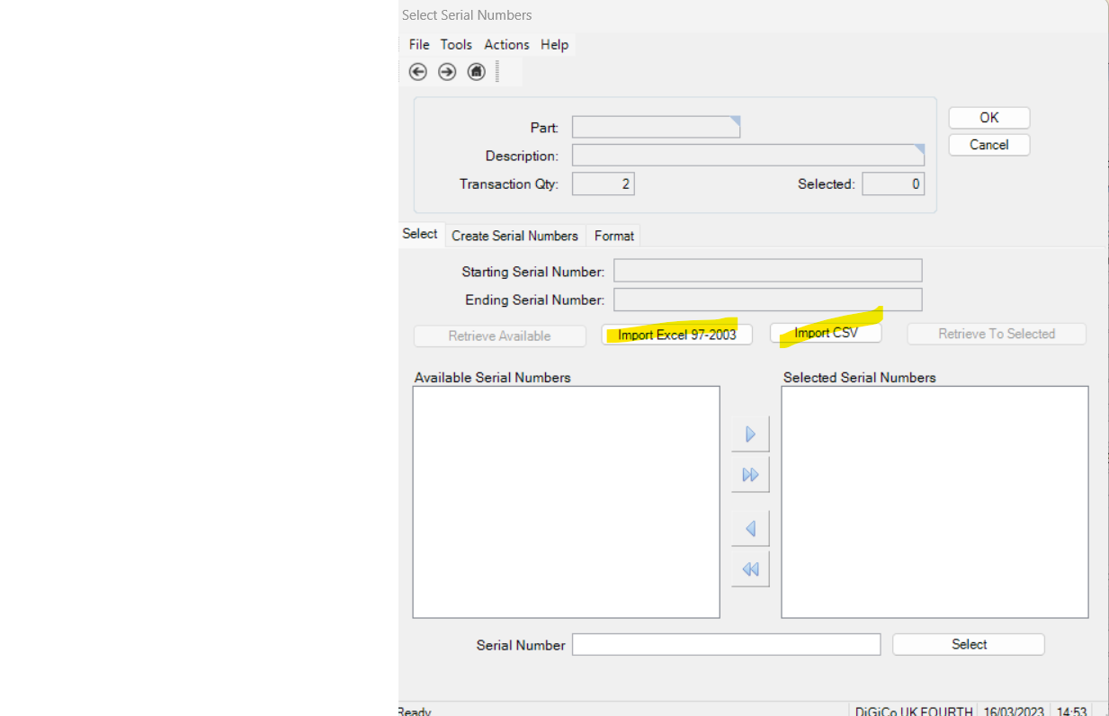

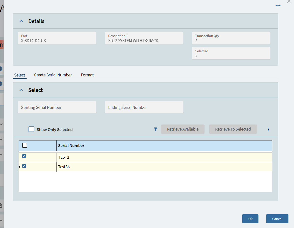

I’m looking for the best way forward. We currently have a customisation on Select Serial Numbers for Quantity Adjust, ContainerReceipt, DropShip, ReceiptEntry which allows us to upload a excel, csv and mass add SerialNumbers to the dataview Available
We are looking to implement this in Kinetic UI via Web Browser
I did look at the File Picker Client > File Transfer Erp but I don’t quite understand how I would pull the contents of xyz file into the slide out panel in the Kinetic UI
Then process the csv file into the grid where No Records Available is currently written.

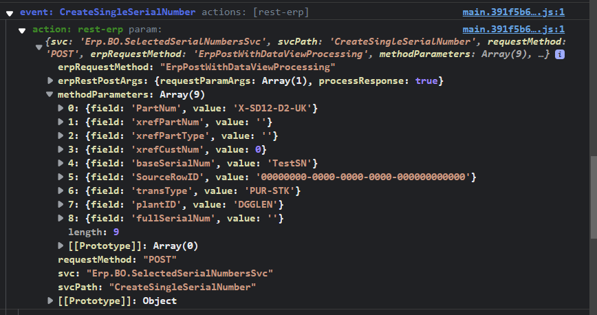

I can only see dataview snf in the console log of DevTools which contains my new serial number if I add it manually
How would I call this endpoint from when the file has been added to File Client Picker and process the contents line by line…

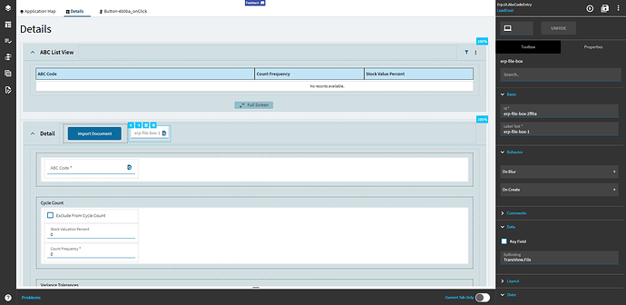

I added a File Picker Client to the form.
It got the id erp-file-box-e7ec2
Set the EpiBinding on that to CallContextBpmData.Character01
(Shortchar01 may be too short sometimes)
Then I added a button to hang an event off of.

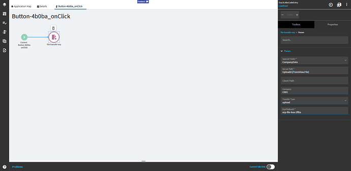

Added an on-click event, and chose the file-transfer-erp widget.
Choose Advanced → Param
Then chose Special Folder CompanyData
ServerPath: {CallContextBpmData.Character01}
Put in Company
Transfer Type upload
ErpFileBoxID: erp-file-box-e7ec2
And I tried it and it worked. File is there.

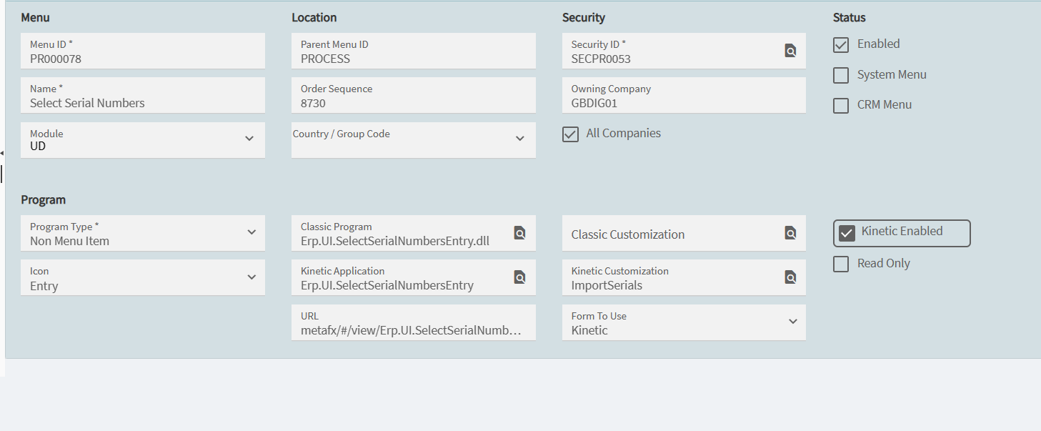

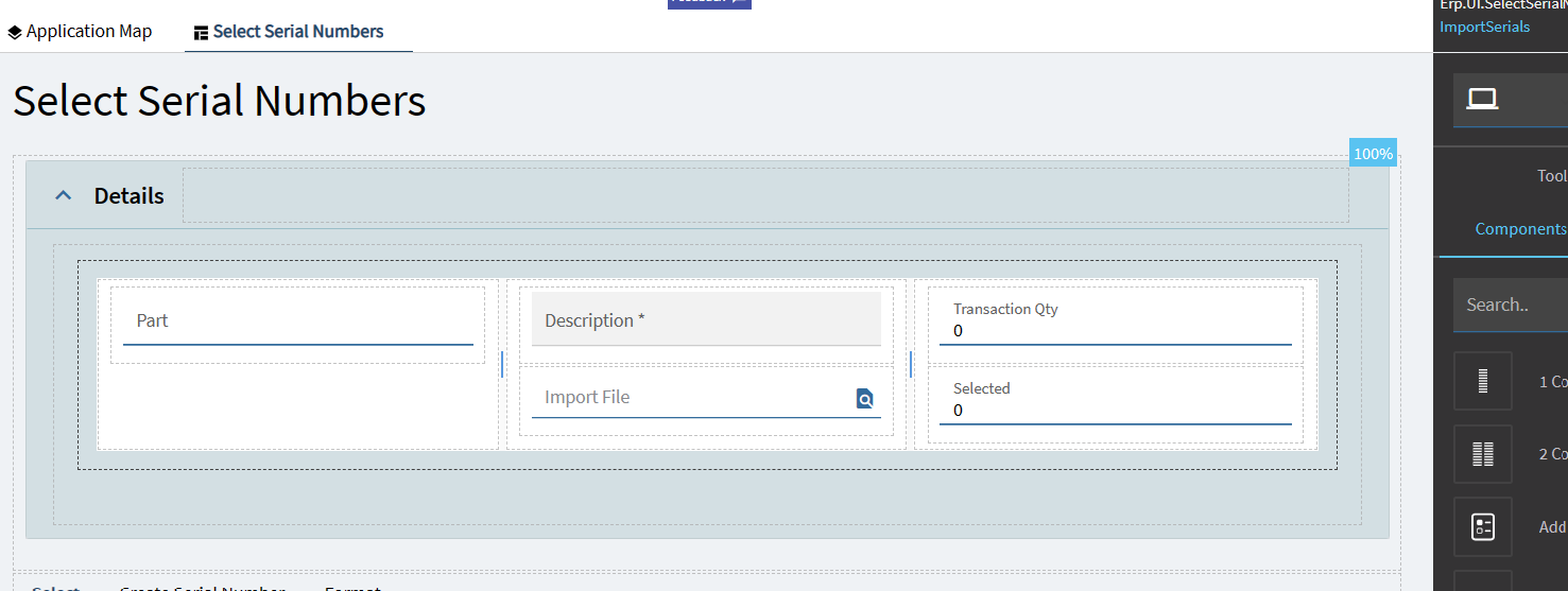

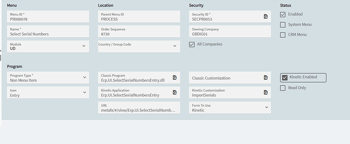

Get a custom layer on Erp.UI.SelectSerialNumbersEntry.dll and have it actually WORK! - I have added 5 different layers… NONE OF THEM DISPLAY!! Just uses base…
My custom layer in Menu…
Using my layer
Added File Picker.
Receipt Entry - Serial Numbers > Slide Out…
NO LAYER!
