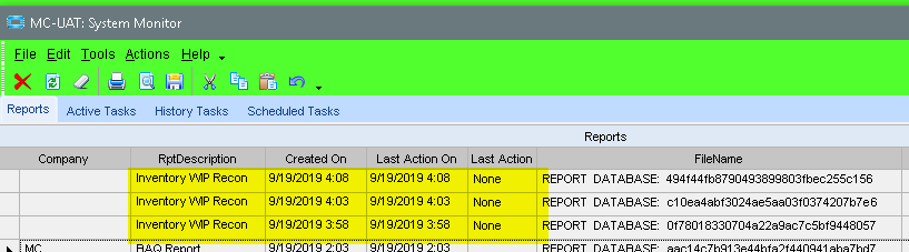

I created a Process Set and added a single report to it. Then scheduled that Process set to run every 5 minutes.
The sys monitor shows the report was created, with last action being “none”.
If they were archived, you could open them from there.
@ckrusen So last action = NONE means the report is waiting to be output from the system monitor? I was looking for a way to locate the file information without having the accounting person go to each of the 40 reports and open them one at a time but that might have to be the solution

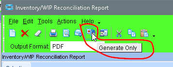

It looks like when you click the “Save Process Set” button on a report screen, it just remembers all the field settings. When that process set is run either manually or via a schedule, the report is submitted with all the settings you selected, just as if you had chosen “Generate Only” on the report form.

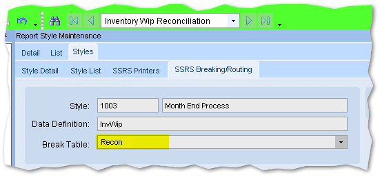

  2. Make a new Report Style for WIP Recon by copying the the one I want to print
    a. Add a new SSRS Break Routing
    b. Select the break table (choose the most generic one available. I chose Recon)
    c. Open the Break Route Designer
    d. Add a Break block, breaking on Company
    e. Add a printer block and set its properties
    f. Save and exit the designer.
    g. Enable the Break/Routing
  3. Repeat step 2 for the GL Report style you want
    a. I choose Company for the break table, and Company as the break field (step 2.d)
  4. Repeat step 2 for the AR Aging Report style you want

I scheduled the Process Set to Run every 5 minutes, And see the following:
In the Sys Monitor:
