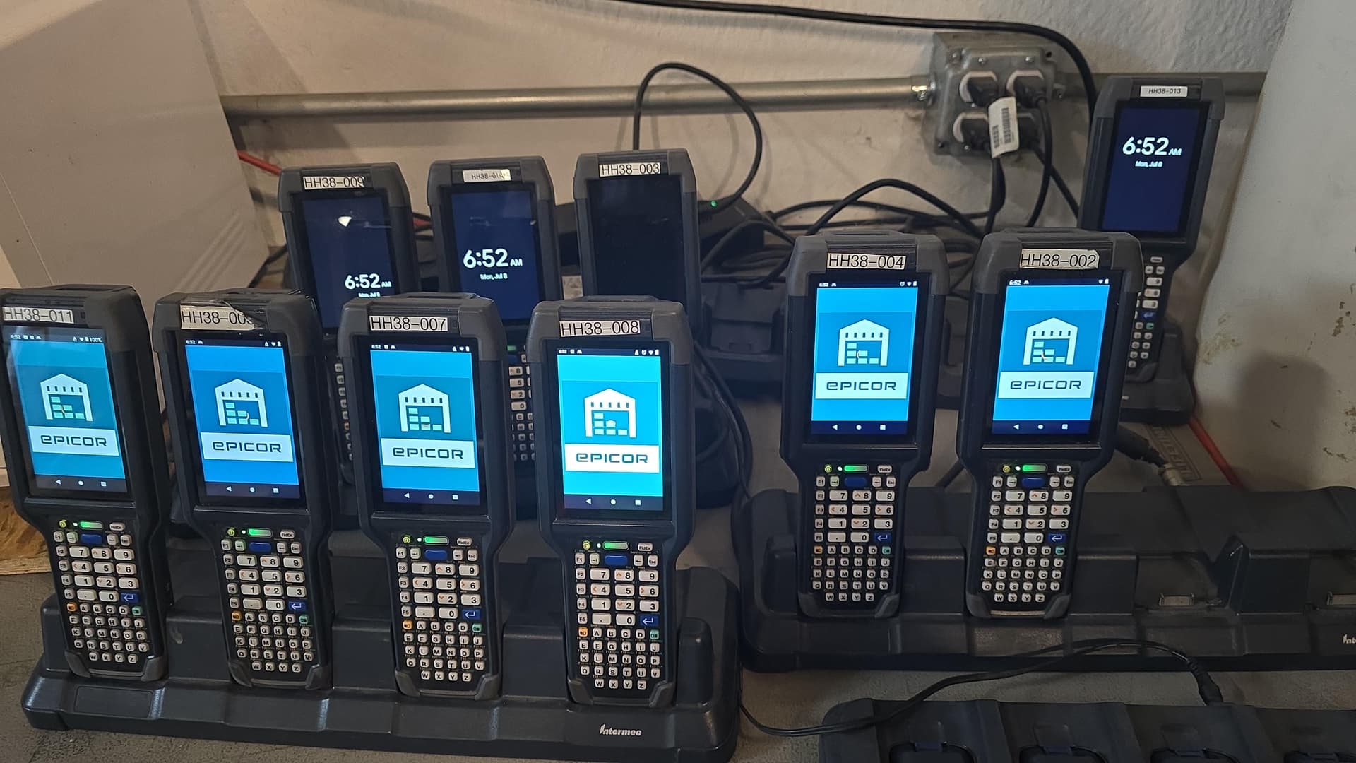

I wish we could see if any BOs were called at that splash screen and if there was some type of error…
Do you have other like models in another plant on the same OS and same firmware?
We are exploring using this app in different parts of our warehouse and are going through the process of trying to support them and we have been trying to tell people that these are the things that can happen. When something like this happens are you the ones supporting them and trying these things out till something sticks?
Have you tried opening a browser on your intermecs in the problem warehouse and connecting to Kinetic?
We once had guns go down for one location and it turned out ISP traffic filtering was to blame. It took a while to identify because nothing else in our system was taking the same exact network path with the same ports.
It’s before it even tries to connect to Kinetic. It’s the very beginning opening of the app. We’ve tried restarting the devices, uninstalling and re-installing the app, clearing app cache and data. You don’t even get to the screens to type in the address for your server.
We have a good Infrastructure / network team in house who does most of it. There are probably 10 different vendor portals for all the network stuff (wireless, different circuits, etc.) that I never go into… For the devices themselves I believe android apps are deployed through Intune but I could be wrong. We also have a ConnectWise setup for remote viewing the screen with users, which is tremendously useful.
Seems like it is an issue with the Android OS. Upgrading our EKW devices that were running Android 9 to version 10+ seems to have resolved the issue for us.
