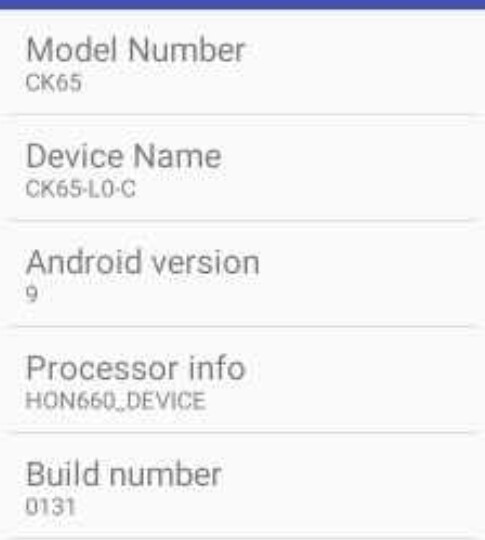

Yes, this was today. Exact same issue that you are describing (stuck at splash screen with no way to advance). The only solution that we could find in our situation was an Android OS upgrade (there might be some alternate solution but we couldn’t find it). Completing that upgrade immediately brought the devices back to normal operation.
Fortunately, we are a single site operation so we had someone onsite that was able to complete the upgrade in person. I believe that he had to download the required software through the Honeywell portal (we are on CT40XP handhelds).
We use Hexnode MDM and keep the devices in single app kiosk mode (EKW is the only app we use the devices for), so as soon as the OS was upgraded, the EKW app auto-launched and functioned as normal.
