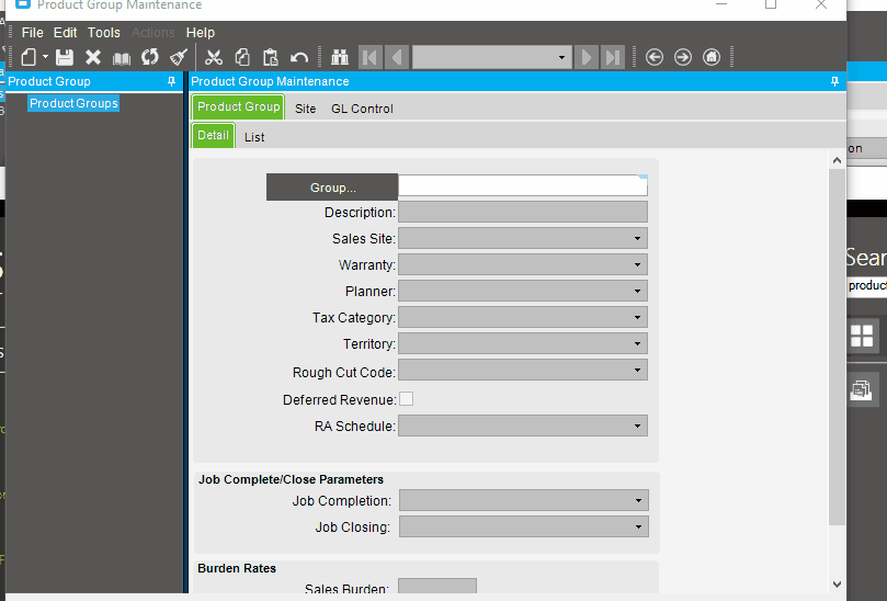

Before:
PS: dont judge the naming lol, wasn’t me.
After:
Not only did it wipe out Custom controls but the code is VB now, so almost as if it ruined the whole layer. If I open it in Customization Maintenance (Its gone there too).

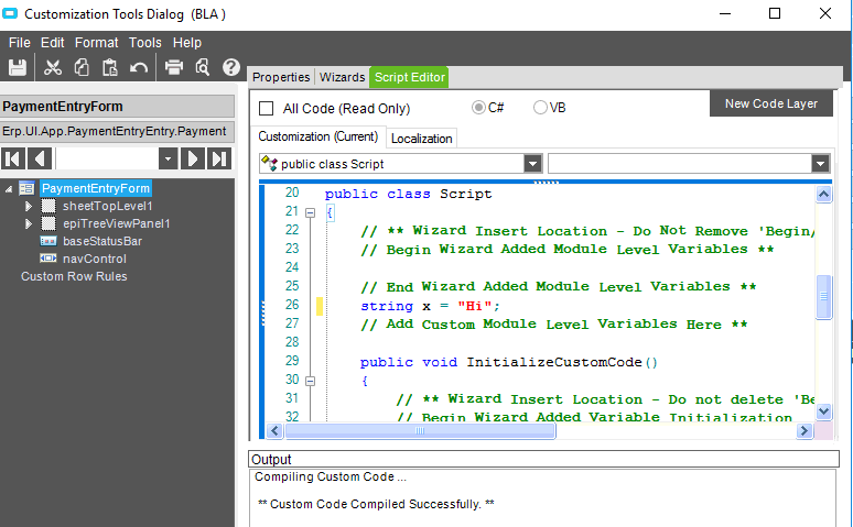

10.2.500 is also affected:
  1. Make a Customization, even just add nothing or string x = “hi”;
  2. Save, Reopen Form.
  3. Actions -> Save Layouts
  4. Reopen Form
  5. Everything is gone, and your code went from C# to VB and is removed.
CC: @Bart_Elia
I also did this in a seperate environment, unrelated to the first. So I can replicate it in 10.2.400 and 10.2.500.

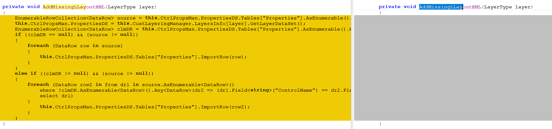

In the Trace it looks like StoreData passes in the truncated customization while the Ice.Proxy.BO.GenXDataImpl.GetOrAdd shows the full code.
After comparing 300 to 400 and 400 to .10 and 500
The one that stands out to me the most is:
Left 400 Base vs 400.10 - PersonalizeCustomizeManager.cs in EpiClientLib.dll
It still uses it in the code in a few places, but looks like the dog ate the methods code in 400.10 and 500.0
EDIT
LOL I added that missing code back with dnSpy and viola! It all works now @josecgomez
Now the question is who deleted that code :smiley: @Bart_Elia
There @Jason_Woods send me your EpiClientLib dll and ill patch it for you, for the time being.

Starting as of 10.2.400.9, 10.2.400.10, 10.2.400.11, 10.2.400.12 and even 10.2.500. The dog ate the AddMissingLLAyoutXML method code in Ice.Lib.EpiClientLib.dll in the PersonalizeCustomizeManager.
FYI - That method is populated in source code so in my ten minutes of triage I am wondering if the compiler optimized away an unreferenced method. hmm…
