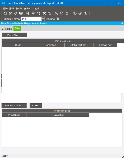

Save Layouts button aside. I noticed some screen grids behave oddly without the patched dll. Perhaps its not just Save Layouts, this Customization has no Personalization Layer.
10.2.400.10 AS-IS:
10.2.400.10 Patched EpiClientLib:
Yup. My grids and custom controls had to also be place at the correct location in code.
