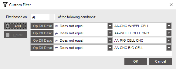

Note, I’ve added another filter on the job number text box since then. That works, but still same results. I get the AA-CNC* stuff on my Op Detail column.
I have gotten around this by using the built in filter on the column, pictured below.
Saved the layout as a personilaztion and it works beautifully. I just don’t understand why my code didn’t function the same way.
Well, that code should be doing exactly what you are doing manually. So if it’s working, you should be able to see the filters in the same box. I can see in your screen shot that the filters for the other stuff is active (a different blue). Do the filters populate like that when you open it the first time?
The coded filters don’t appear in the Custom Filter box. Although, I guess I could preview the entire code and see how it does it from the Custom Filters box.
No, the filters don’t get triggered until a user either selects a resource in the drop down BAQcombo or they start typing a job into the Job text box.
I’m not going to worry about it too much. It works now. Should never fix something that works lol.
