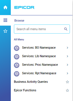

Welcome Oscar!
In my opinion, the best way to learn the Epicor REST API calls is through the Swagger page. In Kinetic, the easiest way to get there is:
https://your_server/your_instance/apps/resthelp/#/home
or
https://your_server/your_instance/api/help
Once logged in, you can search for various APIs.
Note that each API has an OData version and an RPC (Previous called Custom) version. And speaking of versions, v1 is the less secure but OK for this kind of work. When moving to production however, it’s best to use v2 with an API-Key.
The Ice-prefixed APIs will give you system-related information like companies, users, etc.
You can get also the REST Technical Reference guides on https://Epicweb.Epicor.com.
