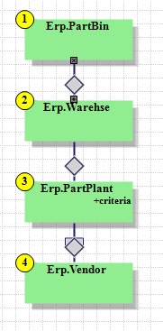

The tables and joins
This is not what you asked about, but I thought I'd explain since there is some wacky stuff here.

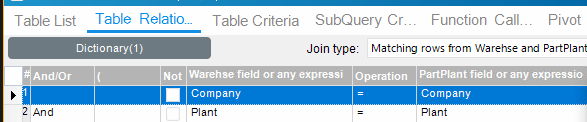

Joining PartBin to Warehouse:
Joining Warehouse to PartPlant

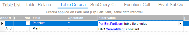

Criteria on PartPlant

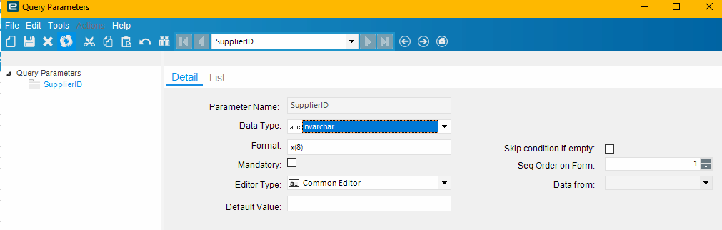

Parameter

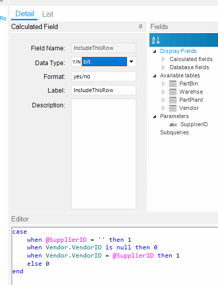

The magic
This is how I do filters. I make a calculated field - typically named this obvious - and do all the logic in it.
All of that was in a SubQuery.

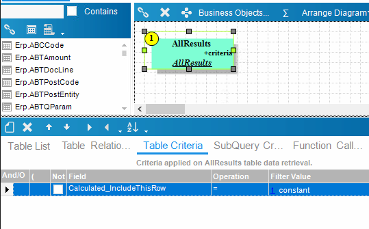

Then I make a top-level query that filters by my calculated column.
