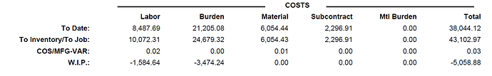

We are seeing strange issues with costs recently and are not sure what has suddenly changed. On this particular job, we are seeing a negative cost in WIP on the WIP report. When I look at the transactions on Job Tracker, I do not see any further transactions after the MFG-STK transaction. We use lot average cost and this job was split from a previous job. On the problem jobs, they typically have a job split involved so we are thinking it could be related to the split.

Looking at the Inventory/Wip Reconciliation report, $10,072.33 was credited to the WIP-Labor account on the receipt to inventory, but only $8,487.69 was debited. Seems like the job split did not move enough costs over. This aligns with the $-1,584.64 on the WIP report.
I have not really studied the process, but if you look at the job tracker assemblies transactions tab you will see the ADJ-MTL from the original to the new job. I don’t know how the labor is shown.
Debit : $8,487.69 actual cost of materials and labor applied to job (Material issuance, labor entry)
Credit : $10,072.33 Cost relieved of the top level part in Epicor after receipt to stk or shipment
$-1584.64 favorable mfg. variance. once the job is closed or capture run, this should move to the variance account from WIP.

I don’t see the $1584 anywhere on the report, but for the account 1351-05\WIP-Labor, the labor transactions total $8,487.69 in Debits but $10,072.31 in Credits from the MFG-STK transaction. I don’t quite understand why these values would not match.
When accounting ran the Capture COS and WIP on the 1st this month, there is a MFG-VAR transaction for only $0.03 for this job.

I appreciate the help. This is what I figured, but not sure why my “To Date” costs are lower for labor and burden. My JobAsmbly table shows 10,072.31 for TLALaborCost but my “To Date” line is 8,487.69 which is why it’s showing the $-1,584.64 on the WIP line. Closing the job again has not moved those costs to the variance account.

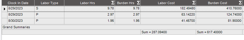

Took another look at the production detail report and compared against the labor transactions and was able to narrow the issue down to a specific operation. For some reason, this operation is showing 92.50 actual setup hours when there is only a single Setup labor transaction for 9.78 hours. Any idea on where I can find out where these additional hours came from?
The difference between the Labor/Burden costs on the production detail report and the sum of the labor transactions for this operation matches with the $-5058 that was shown on my WIP report.

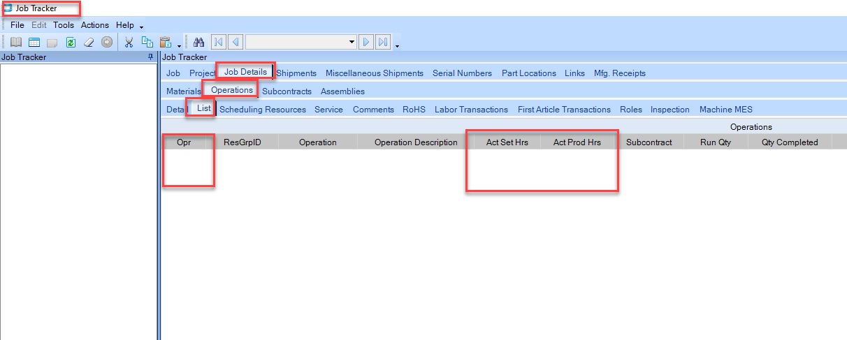

You could look at the job tracker to see which operation has these additional setup hrs.
Go to job tracker > Enter job number > Job Details tab > Operations tab > List
You might have to scroll to the right to find the actual setup and actual production hrs. i have mine setup this way below.
Also, you could highlight the operation with high setup hrs. and then click on the “Labor Transaction” tab and click retrieve to get the details of that operation from labor entry.
