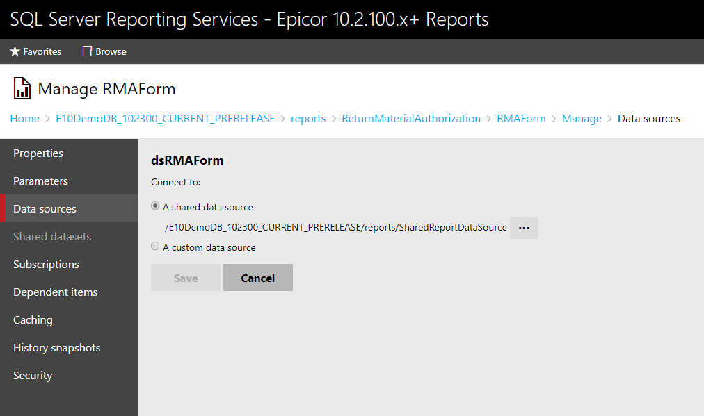

  1. Do standard reports work fine and only custom reports are impacted?
  2. It looks like you are working with the RMA report. Have you confirmed that the data source for this report is pointing to the correct shared data source? It should be in the reports subfolder of the root folder specified when the SSRS reports were deployed from the Epicor Administration Console.
  3. Have you confirmed that the shared datasource itself is pointing to the correct dataset db?
  4. Have you confirmed that the reportdata connection string is pointing to the same instance/database that the shared datasource is?
Hi Nathan,
Thank you for jumping in, all of the other custom reports work fine. I checked out the data source for the report and it is pointing to the same data source that all the rest of the custom reports are pointing to, the only shared report data source we have set up, the one in the subfolder of the root folder. I have confirmed that the shared datasource itself is pointing to the correct dataset DB.
