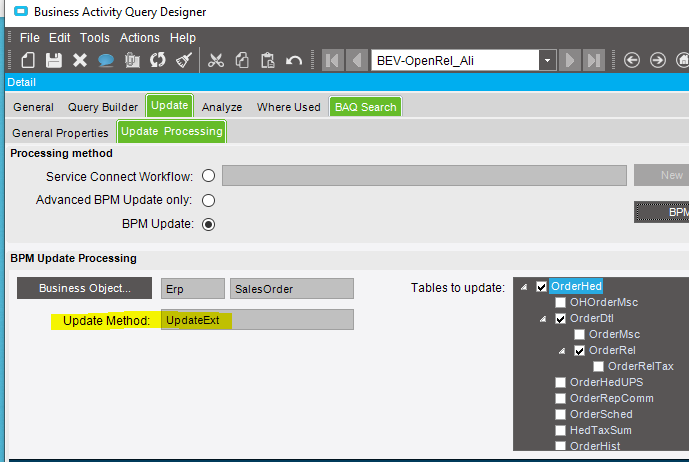

Updatable BAQ uses UpdateExt method on the relevant BO

this is what i suggest, use the UpdateExt method directive on ShipHead and InvcHead and see
