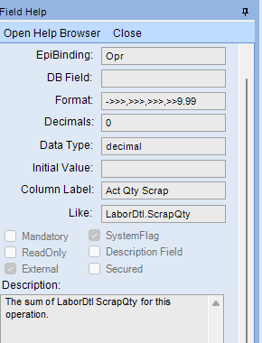

I have pulled the help for both and they both state in description the same thing.
“The sum of LaborDtl ScrapQty for this operation.”

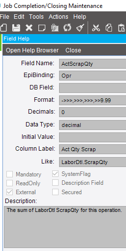

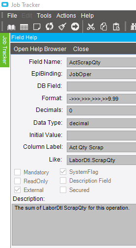

Job Tracker:
Job Closing:

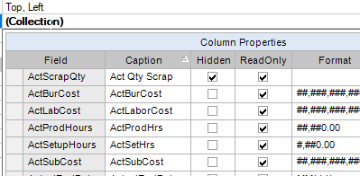

I was looking under customizations / collection of items displayed and assumed ActScrapQty was a field under JobOper but I don’t see the field in the data dictionary viewer. I guess I would list labor detail records for scrap for your operation just to verify the total. Still not sure of the reason Job Tracker doesn’t show this, maybe an adjustment not showing?
