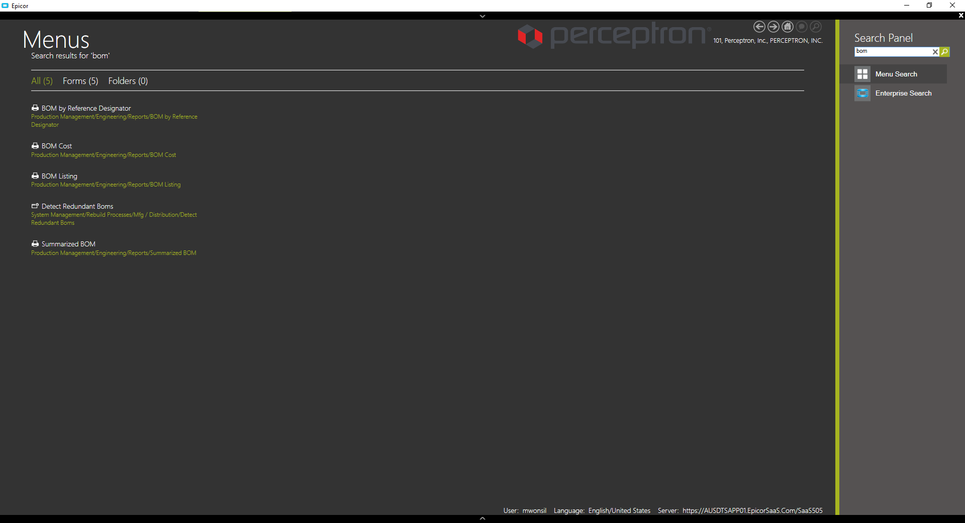

Hey Carol,
Actually, there is a menu search that is built into the Modern Shell that searches all Menu space BASED on the user’s access:
Works pretty well.
Mark W.
Thank you Mark!
We are still on 9.05.701, however, we have an E10 test environment and I can use that search feature to see if reports are being used. If not, I can delete them and not bring them over. Great tool!!
