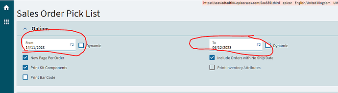

I am trying to to get the FromDate and ToDate parameter in the SO Pick List Report when it is printed. How do I retrieve the parameter in custom code? So far when I check in the forum most seems to be for setting the parameters and not retrieving it unless I am mistaken?
To add more details to what I am trying to do I want to be able to retrieve the value of the From Date and To Date inside the Sales Order Pick List Report into custom code but I don’t know where to start.

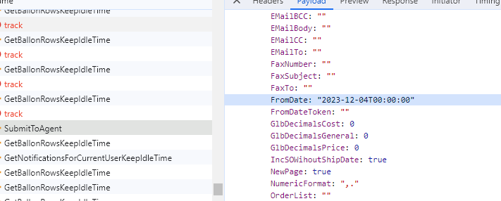

Using Developer to I understand that in the SubmiToAgent ds.ReportStyle.SOPickListReportParam[0].FromDate and ds.ReportStyle.SOPickListReportParam[0].ToDate is where its stored at but how do I go about calling it in BPM for SysTask?

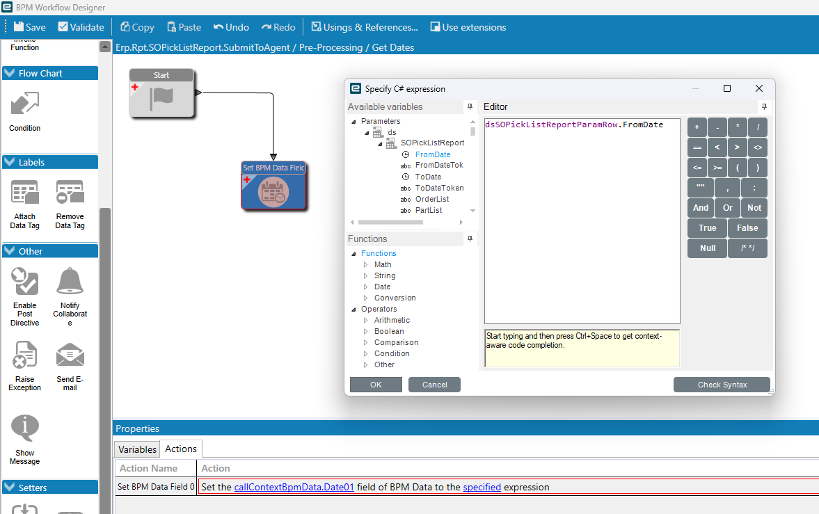

You can use a pre-processing Method Directive on the Erp.Rpt.SOPickListReport.SubmitToAgent method to grab the FromDate and put it into a BPMData Date field where you should be able to pull it into your report.
Is there a way to pass this value over to the SysTask Data Directive? Or to have it pulled in the Systask Data Directive?

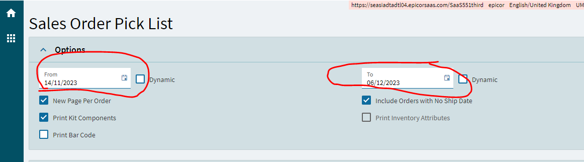

Scenario 1 - Users don’t filter any Order Number and the SO Pick List Report just takes all Order that meets the Date Range requirement.
Results: Report printed all within range but my code did not insert anything because it was checking by Orderlist which was empty. Upon studying I found that it was because my code was using the Orderlist and when no Order Number was taken, the Orderlist is “”.
Scenario 2 - Order filters out say 2 orders, but 1 of the order NeedByDate is not in report filter range.
Results: The report printed out only 1 order number but my code inserts into the 2 Order Number rows instead of only 1.
For both the scenarios I realise I need to pull out the Filter Range Date value in the SO Pick List for my code so it can insert to the correct counter fields BUT I need to have it done in SysTask because I only want the counter to be inserted AFTER Report has run “COMPLETE” and not insert if it ran on “ERROR”.

Just to update I realised I was going in a very unnecessary big roundabout. I didn’t realise there was a sysTaskParam table that stored the FromDate and ToDate param already so RIP me I spend 2-3 weeks creating a UD field and cracking my head trying to figure how to insert it to the UD field because the SOPickList method is just adding the rows to sysTask ![]()
I got it to work now by pulling out from the sysTaskParam table which can be done in the Data Directive and using that to filter and boom counter inserts filtering the needby date
