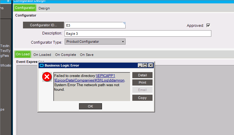

I have an employee in our test environment who is getting an error of Failed to create directory.
In the error message, the network path goes to a server that is no longer in use.
Where is the location set for configurator?
Picture of error below. You will notice the \EPICAPP1, that is not valid anymore.
I believe that is a folder path defined under System Agent Maintenance.
