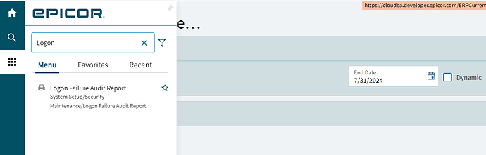

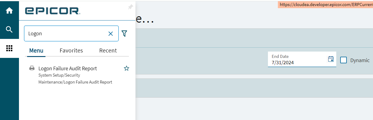

you should be able to see the Logon Failure Audit Report, as it is available to cloud customers. I just searched and found it on the menu in my cloud instance:
@timshuwy I can see the Logon Failure Audit Report, however failures from the web browser do not show on the report as they are not in the Ice.SysActivityLog table.
