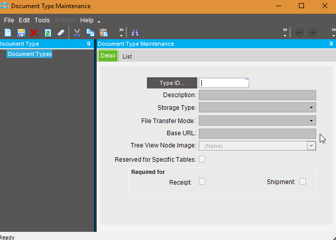

jhawt
(Jason Hawthorne)
December 21, 2017, 7:40pm
4
You can change the file path for different document types at System Management > Document Management > Document Type Maintenance. It’s the Base URL field.
