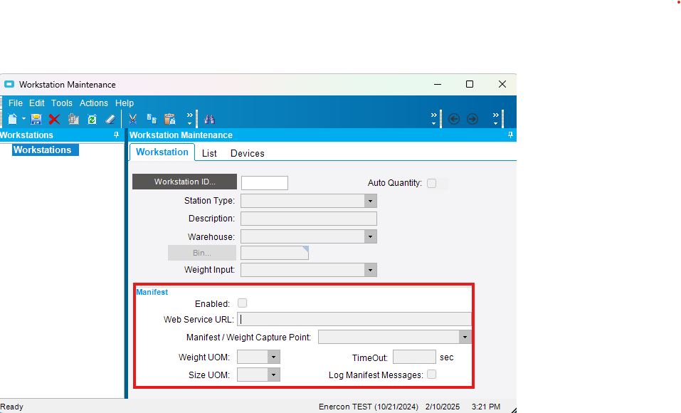

was the user in a workstation tied to quickship when the pack was freighted?
Yes, the user has never had any issues bringing up Pack IDs in Quick Ship before.

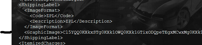

The label isn’t really in QS. The GraphicImage field is the ZPL label.
They send the request to the carrier and the carrier sends a reply back with the label and the PrintMon service just pushes that to the printer.
