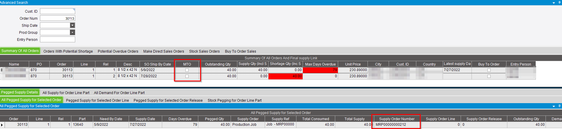

Order Shortages showing the soft link

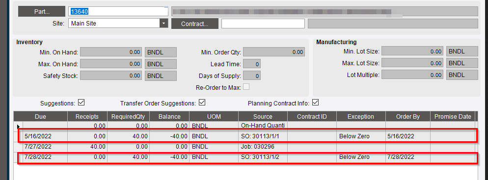

Time phase for the part showing there is no oher demand causing the MRP job. Just these two not firm releases. I should note the MRP job was deleted before I took this screenshot but was still in pegging since that’s not “real-time”

That one is a firmed job. That will supply the second release. The first release is the one causing us issues. The second release was already firmed with a ship date. The first release was not firmed as it was waiting on a ship date from the customer.

It looks like since you already have a firm Job in the system, Pegging is saying the qty produced from that job could supply the unfirm release. Then, since that job qty is gone, it is suggesting a job for the firm release for July.
Neither release was firmed. I misspoke. Our scheduler manually created the job for july and went off menu because she knew, internally, the date for that release was good. She then deleted the MRP suggestion for the first release we see in pegging because she knew that date was not good on that release.

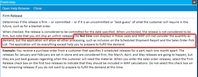

There are two things from the help that I think apply here.
“but note that you still ship an unfirm release.”
“The application will do everything except help you to prepare to fulfill the demand.”
You will not get a suggestion for the May date because it is unfirm, but the system is still expecting you to ship it. So, when it sees that 40 will be in inventory, it assumes you will use that 40 to fill the May release. Then (if my above questions are correct) since the July release was manually pegged which made it “firm”, the system is suggesting a new job to meet that “firm” unfirm demand.
