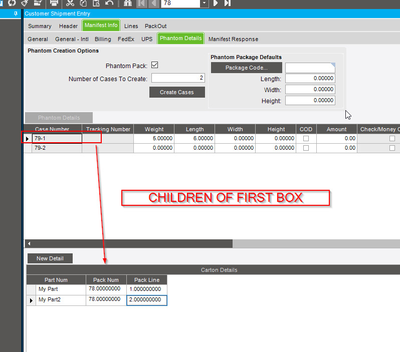

Like @Chris_Conn said you can’t its called a “Phantom” cause its not real. Basically it just gives you X boxes to pack stuff into it doesn’t care what goes in each box. You could do a customization with a UD table to relate lines to boxes i supose
Yes, that’s my dilemma. Even with a UD table, how do we determine which lines are in which box/pallet? I’m trying to avoid manually entry but I’m not seeing any other way.
You should be able to relate the UD table as a Child of the carton (each carton) and then have them select enter which lines go where. But yeah you’ll need some manual entry.
