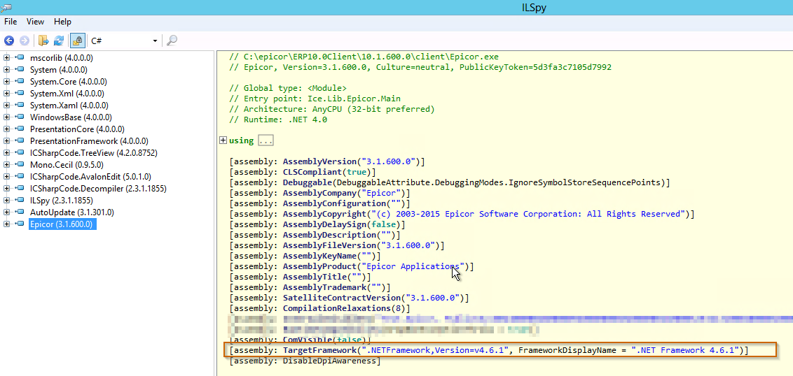

According to the manifest
[assembly: TargetFramework(".NETFramework,Version=v4.6.1", FrameworkDisplayName=".NET Framework 4.6.1")]
Thank you, where can we get to the manifest?
https://media.tenor.co/images/3978d2e2df94eca4bc457522c4df6c62/tenor.gif
Hehe… JK you can use reflector for that.
I use ILSpy and open the epicor.exe
In addition if you try to compile it under a lower version while referencing Epicor’s DLLs with a higher .NET Version your Visual Studio should throw a bunch of Warnings.
