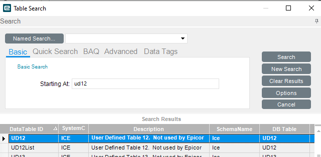

Anyway, I am about to set some field names for UD12 in Extended properties and there are 2 tables in the search. What is the “List” one? It has the same 100 columns as UD12.

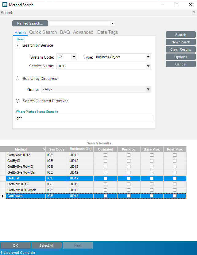

UD12 and UD12List are the tables within the Business Objects. There are calls for GetRows, and GetList. The GetRows returns a full dataset of all fields, where the GetList only returns key fields. You can see they both reference back to UD12 as their DB table.

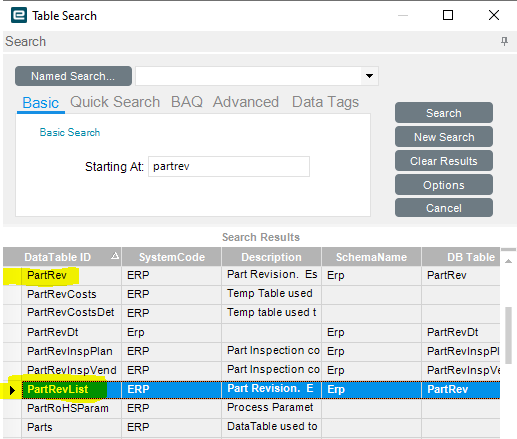

So, I inferred from your answer that other tables are like that, and I had not noticed this before (since I never have any reason to visit Extended Properties unless it’s a UD table). It doesn’t jump out at me with the other tables (like PartRev) since there are often others in the middle, alphabetically. But there it is.

Edit: I really am curious about all that. But, of course, my original reason for asking was laziness. I was curious if I had to do my extended properties in both tables, doubling my work.
In the base application I would guess that UD12List is not used anywhere. The ‘GetList’ method is used when performing searches or populating dropdown lists. If your customizations ever perform a search for UD12 records, or call the GetList method in code somewhere, you will need to modify the UD12List table.
If not, modifying only UD12 is probably sufficient.

For proper comparison, check Part versus PartList. PartList returns 43 columns where Part returns 316 odd.
