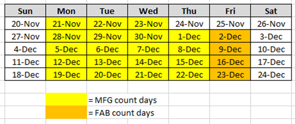

  • Let’s make a period = Nov 21, 2022, to Dec 23, 2022
    • And imagine that the system decides to call this “period 12”
  • And two schedules for this period:
    • One for the MFG warehouse that uses the MfgCycle calendar (Mon-Thu, but we are off for Thanksgiving, Nov 24)
    • One for the FAB warehouse that uses the FabCycle calendar (Fridays only, but we are off for Black Friday, Nov 25)
    • (I chose to use those calendars on those cycles. If I wanted, I could have swapped them, though that would make no sense. Or I could use the same one for both.)
  • This will generate:
    • 19 cycles (numbered 1-19) for the MFG schedule in period 12
    • 4 cycles (numbered 1-4) for the FAB schedule in period 12
    • (So, notice there is more than one “cycle # 1” in period 12!)
