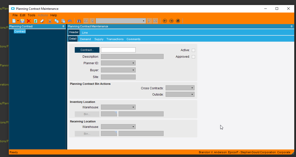

Your tying the Planning contract to the specific warehouse and bin so I can understand the dilemma. I’m assuming that you are not wanting to have the part in any other bin than this one. Perhaps the Outside field in the planning contract is what you need to change? Getting a bit far out of my wheelhouse now.

Right Planning Contract requires the parts to be in a specific bin (specified in the planning contract setup) the issue is that realistically we aren’t going to keep that material in one specific bin in the warehouse.

I think Planning Contracts were around before PCID so that’s probably the reason. Have you tried what happens if you changed the Outside value on the Planning contract and then moved the inventory to another bin? I’m curious. Particularly if you can move it to a bin not in the planning contract warehouse.

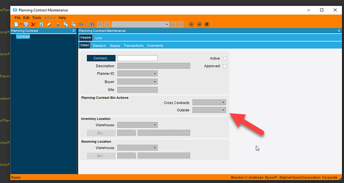

What options do you have in the Outside drop down?
I’d look at that and try testing receiving (or inventory movement) to a different bin other than the one on the contract, when the Outside option is set to another value other than stop.

That’s for moving stuff in and out of planning contract bins. You can lock it down if you don’t want people being able to add or remove things with just inventory moves into the bin.
Once you move stuff out of that bin, MRP treats it as a hole that needs to be filled. So you can’t receive it to that bin, and then move it out of that bin.
