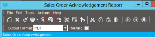

I then tested ‘manually’ emailing the report with the SSRS Email option from the toolbar since I suspected both APR & SSRS emailing uses the same backend functionality:
This also resulted in an error message in the System Monitor, but slightly different:
Program Ice.Services.Lib.RunTask raised an unexpected exception with the following message: RunTask:System.Net.Mail.SmtpException: Failure sending mail. —> System.IO.IOException: Unable to read data from the transport connection: net_io_connectionclosed.

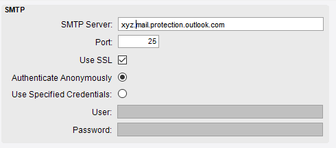

I checked the Company Maintenance SMTP & Global Alert settings and even trying variations and nothing resulted in a successful result.
I then compared with another client and theirs work fine with similar settings.
The only real difference (other than the SMTP Server) is the Port. The non-working environment is using port 25 (relay only?) and the working environment is using Port 587

The SMTPMailer reads the company SSL Checkbox so it should honor whatever you have in Company Maintenance.

If you do use 587 you may need to check Use SSL in Company Maintenance… oddly enough we require it for our port 25 relay :slight_smile:

the SSL Checkbox is not enabled, I don’t know if the Email Server will even accept that.

When you use the ‘manual’ SSRS Email option there is no option for the From Email address.
