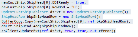

Hi there,
that thing really confused me too…I wanted to set the ReadyToInvoice but faced the same issues you mentioned above.
I have found a workaround that helped me to overcome the problem using the UpdateExt method. (@10.2.200)
let’s say that dsShipHead_iterator is the original ShipHed record having set the readyToInvoice = true and rowmod = U
Then…
Erp.Tablesets.UpdExtCustShipTableset dsExt = new Erp.Tablesets.UpdExtCustShipTableset();
Erp.Tablesets.ShipHeadRow bkpShipHeadRow = new Erp.Tablesets.ShipHeadRow();
BufferCopy.Copy(dsShipHead_iterator, ref bkpShipHeadRow);
dsExt.ShipHead.Add(bkpShipHeadRow);
svc.UpdateExt(ref dsExt,true,true,out cError);

I’m in the same situation. Same error, same idea of wanting to un-ship. And my shiphead is getting deleted but leaving the shipdtl!
I’m calling in this order:
  1. GetByID
  2. CheckPCBinOutLocation
  3. Setting ready to invoice as false and row mod on shiphead to U
  4. Calling UpdateMaster
    I’m on 10.2.300.15
We were able to get by this by using the following instead of your step 4:
new
ShipHeadRow bkpShipHeadRow = custShip.ShipHead[0];
ShipHeadTable st =
new
ShipHeadTable();
st.Add(bkpShipHeadRow);
dsExt.ShipHead = st;
csClient.UpdateExt(ref
dsExt, true,
true,
out cError);
Hope this helps!
Boom! That fixed the issue. Thanks!
