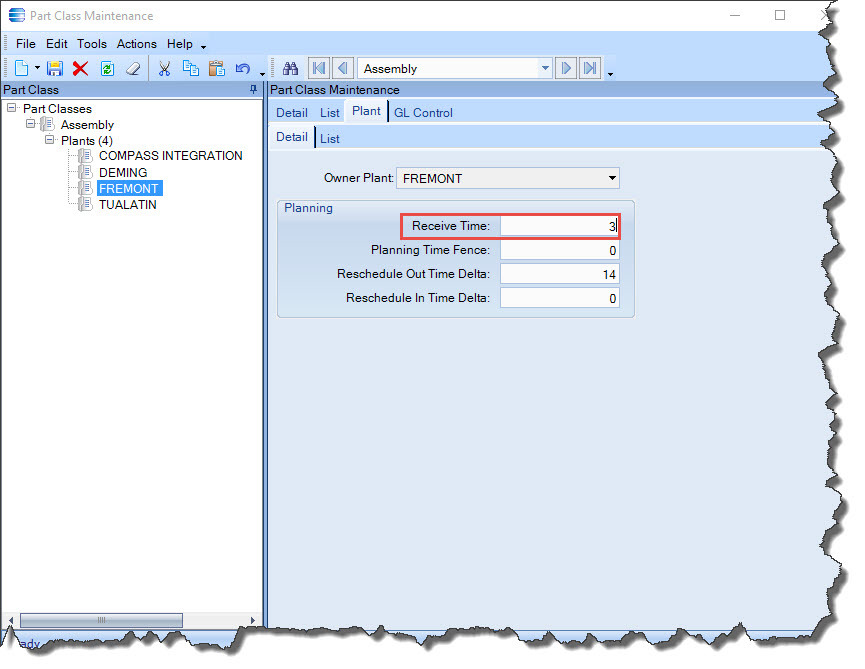

How about Part Class and Receive Time Parameter
I’m on 10.1.4 soon to be .500 Hopefully there will be info on Contracts at Insights… ? I’m new to Epicor and purchasing contracts is completely new.
Curious about what you would set up…
In our system, we use the the Part Class to set a receive time of 3 days.
You can see the affect on the job.
You can do similar cushions on purchased parts. Typically, material required date = operation related start date, but you can add a receive time. So if Material should be in by 3/10, purchasing will get the suggestion to bring it in 3/7
If you have a set number of offset days you need you can do that with with
the receive time to back up the job due date.
If want more hours or days between operations then you can go to the
resource group and add move and or queue hours.
You can see the affects of these on the job scheduling board.
